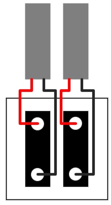

The existing switches have 2 gangs (for 2 lights) - each with T&E to the fitting with a live common and switched return like this: -
This makes sense and is like wiring 2 different wires to 2 different switches, but in the same enclosure. Though I'm aware it's also common to have a single hot feed in and "jumper" to the second common terminal to feed the second light in some 2-gang switches.

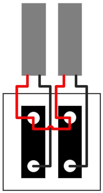

I have another switch in the house (outside bathroom) that looks like this, whereby there's what appears to be 2 x T&E but also a jumper in place between the 2 commons: -

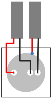

So when replacing the switches, they generally only have a single common with multiple switched outs as per the diagram below. The question is what should I do with the "other" common feed to the switch (blobbed in blue below)...
For the second one above I assume I simply connect both commons into the single common on the new switch (as they're bridged already). For the other however, do I need to bridge those too, or simply use one of the feeds and put a closed-end terminal on the second and don't use?

As to your first question, are both the lights on the same fuse/MCB?
If they are then you can just put the 2 red live cables together in the common terminal.
If they are on different fuses then you will need 2 x 1 gang switches.
