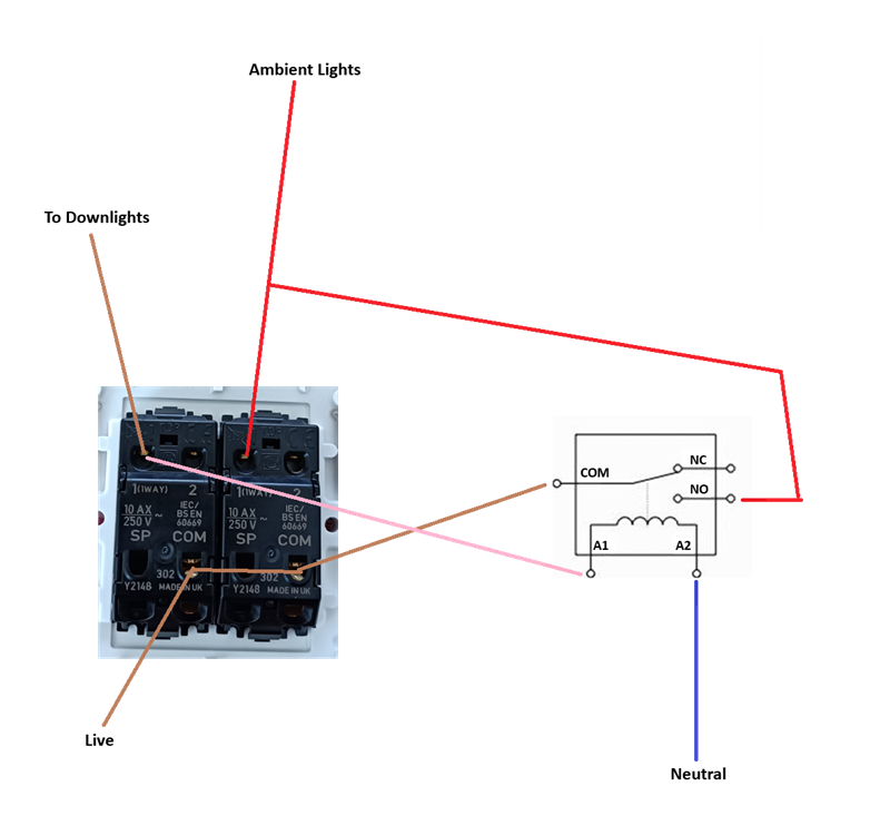

I have a 2-gang light switch on one plate, each gang controlling a separate lighting circuit:
1. Downlights
2. Ambient LEDs
Both circuits are separate, but I want it so that:
Ambient lights can be switched on by themselves
When I turn ON the downlights, the ambient circuit also turns ON if it isn’t already turned on.
What’s the correct way to achieve this?

Looking at IFTTT, or if this then that, many smart switches allow the use of IFTTT, but hard-wired, it would need a relay, or use of DC, had the same problem with central heating, with one boiler serving both main house and flat, and stopping back feeds.

I’ve thought through the looping idea but I don’t think a simple loop will work for what I need.
The wiring is currently as follows on one plate:
  • Permanent live into COM of the downlight switch
  • COM of downlight switch looped to COM of ambient switch
  • L1 of downlight switch to downlights
  • L1 of ambient switch to ambient lights
If I also loop L1 to L1, then turning on the ambient switch would back-feed the downlight circuit and turn the downlights on, which I don’t want.
What I need is:
  • Ambient can be switched on by itself
  • When downlights are switched on, ambient is forced on
  • Ambient switch must not be able to power the downlights

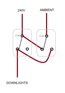

i had started to answer , asking if 2 way switches as well - so an L2 with an actual screw connection , but i see @EFLImpudence has provided the drawing i was making for you
so long as 2 way switches
what about using a AC relay and putting the relay into a enclosure. something like below maybe

I think I understand the diagram. This is what it does in practice:
  • Ambient switch ON → Ambient and downlights come ON ❌
  • Downlight switch ON → Downlights and ambient come ON ✔
  • Either switch OFF → Both go OFF
So it effectively makes both switches control the same combined circuit.
What I need instead is:
  • Ambient ON by itself
  • Downlights ON forces ambient ON
  • Ambient ON must not turn downlights ON
which is how the diagram is drawn by
@EFLImpudence
as far as i can see - both switches in ON position
- only ambient lights will be on
if ambient lights switch to off and downligts OFF - then they will both will be off - providing the downlight switch is OFF
if the downlight switch is ON , then ambient lights are on
i think it works as you want
if downlight is switch is ON (downlight will be ON & the ambient lights will be ON), no matter if the ambient switch is ON or OFF ambient will be ON
if downlight is OFF (downlights will be OFF) , then the ambient switch will either switch OFF or ON the ambient lights
as mentioned a few posts ago post No 10 - you need 2 way switches - which you most likely have - BUT need to confirm they are not 2 gang single way
