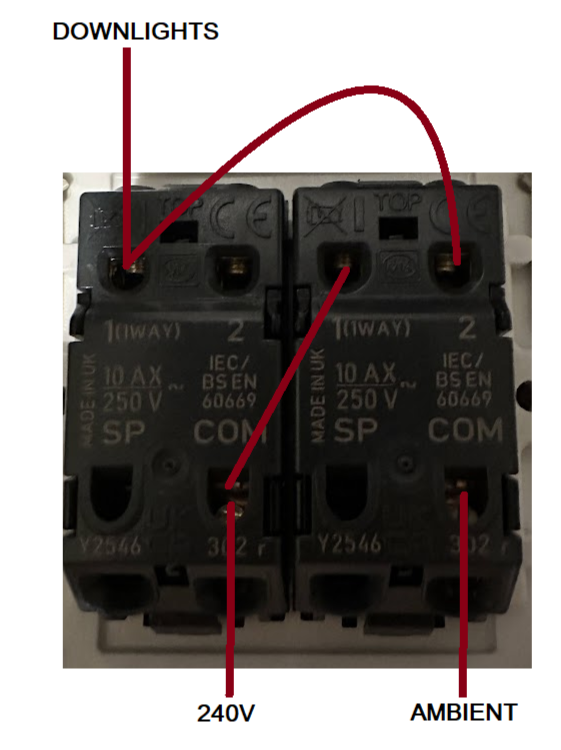

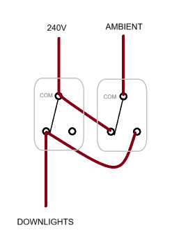

2-gang light switch - how to make one circuit switch on the other?

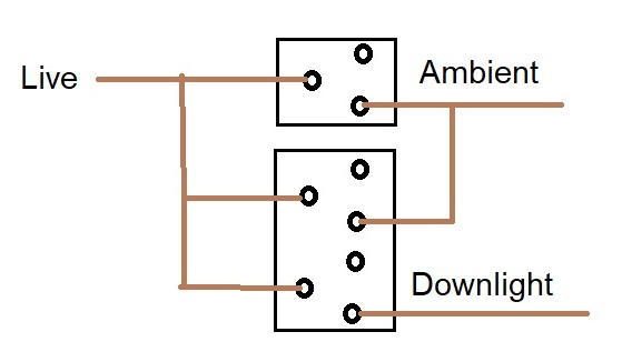

If you can change one switch for a two pole switch then this maybe worth trying
