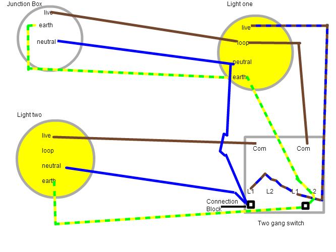

2 lights, one spur, only one light working
Catch 22. If it was a standard setup, I wouldn't have needed any help!

This what you require:
Light one to switch on and off
Light two only to be able switch on when light one is on, so when light one is off, so is light two.
Is that correct?
If so
T&E from junction box to light one.
Brown core in ceiling rose loop or terminal block (not live of lighting)
Blue core to neutral terminal of fitting.
Earth to earth. sleeved green and yellow
From the first light you need to take a blue core neutral, from neutral terminal, so now you have two blue cores at that terminal.
This blue core goes to light two and is located at the neutral terminal.
From light one to switch, you run T&E terminate another brown core at loop/connection block (not the live at light)
Terminate blue core sleeved brown to live at light one.
and earth to earth sleeved g&y.
This cable at switch is terminated with brown to common, blue sleeved brown to L1. at gang one
A link can then be but across L1 at gang two either brown core or blue sleeved brown.
Then a brown core is terminated at common of gang two, from there it is run to light two and terminated at live of fitting and an earth is also run from switch to light two and terminated at earth terminal.
That should do the trick!

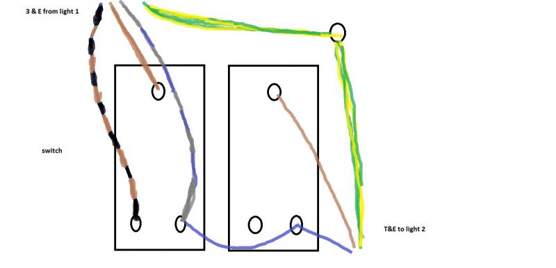

May I add that it maybe easier to run three core and earth to the switch from the light one, to bring in permanent live(brown core) Switched Live (Black core to be sleeved brown) and neutral (grey core to be sleeved blue) plus earth.
The blue neutral between light one and two can then be omitted.
So your neutral conductor would be looped in at the switch via grey core from neutral terminal of light one, so at light one at the neutral terminal you will have blue from junction box and grey from switch.
At the switch the grey core can then be put in connection block, with a twin and earth then taken from switch to light one. The blue core of the twin and earth then connected to grey in block (with nothing else). So then to light two with brown core from common on gang two of switch to live of fitting and the blue to neutral of fitting, plus the earth.
Hope that does not complicate things, but would help regarding using two and three cores, rather than using singles.

you mean like this
FGS Will you please wake up and smell the coffee and PLEASE take time out to learn and understand how circuits work.
What you have shown there would be a disaster.
And the fact that you can't see that is proof that you are not yet ready to be doing anything with light switches except flicking them on and off.
You are still trying to do electrical design on the basis of ignorant guesswork.
STOP.
NOW.
you mean like this
no
more like this
The neutral is not switched and goes to terminal block at switch not com, L1 or L2 then to neutral of light 2.
You only need to link in switch lives at the L1s.
No need to take that to light 2.
The brown in com of light two (which will become a switch live, with this set) then goes to live on fitting.
This should then function as you wish it.
