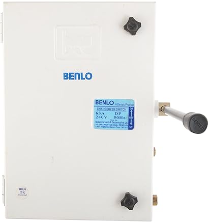

There are, of course, plenty of big chunky 2-pole, 3-pole and 4-pole 'changeover switches' out there but, quite apart from the size and cost, I'd prefer something that doesn't look as if it belongs in an industrial switchgear room!
Oh go on go on go on
