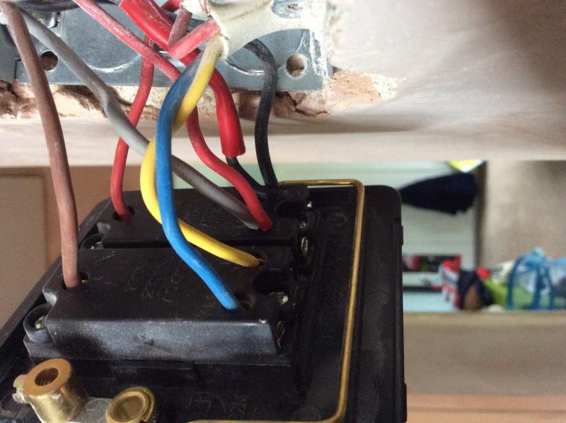

Ok so I hope someone can help with my little problem?
What I have at the moment is downstairs in the hall I have a two gang two way rocker switch which I can turn on/off both upstairs landing lights and downstairs hall lights, then upstairs I have two way two gang rocker switch which I again can turn on/off both upstairs and downstairs lights, at each switch I have one old 3 core red/blue/yellow one new 3 core brown/grey/black and one 2 core red/black, what I would like to do is change the downstairs rocker switch for a 2 way 2 gang dimmer switch which I have purchased from screwfix I got the switch home expecting 6 connection holes ie 2 separate L connections two separate L1,s and two separate L2s as per the same as rocker switch but no what I have is 5 connection holes from left to right on the back of the switch I have (~1) (~2 ) (L) (~1) (~2) so my question is how do I wire this up or have I brought the wrong switch for what I want any advice would be greatly appreciated

A photo of the wiring instructions and alsoof the wiring of both switches might help.
Pic one is landing light switch pic two is hallway light switch pic three is wired up dimmer switch

Yes I am aware of that thanks all we would like is to be able to dim the downstairs lights, it did come with instructions but they are what prentice boy of Derry posted and don't really help as I have 3 sets or wires at each switch and also the upstairs lights and downstairs lights are on different circuits

But you've bought a 2-gang dimmer, so the upstairs light will also be on it.
Then you can't use that dimmer, as it has a terminal in common for both gangs, which will join the circuits. You need one with 2 sets of separate terminals.
Agreed. This is a problem with a lot of these "imported technology" dimmers. I had the same problem with some Retrotouch dimmers in a similar situation. They are just fine if everything is on a common circuit (like all upstairs, etc) but fall down when there is an upstairs/downstairs situation.
You also have to seriously rejig the wiring to make it work like it wants to work. Not an easy job for the DIYer who doesn't understand what all those coloured wires are for.
Thanks yes I'm aware that upstairs and downstairs will both be on a dimmer when all we really want is to dim the downstairs but I could not find a combined dimmer rocker switch in the style we want, I did expect when I bought this to find the common terminal separated as in the rocker switches it doesn't state anywhere on the product that it only has one common terminal for both gangs, and I wasn't sure if I was missing something but you have both very kindly helped me, so back it goes to screwfix and off to find another dimmer with separated common terminals thanks again gents for your time
