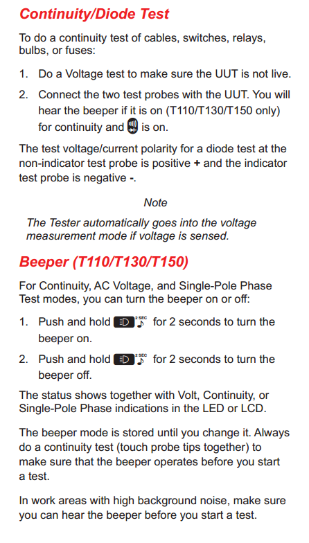

Touch the probes together.
Does it beep and show a different reading than Voltage?
When I touch the probes together, everything lights up and the unit beeps. This includes the voltage display and the red lights across the side indicating the voltage detected. I was advised to rely on the lit up voltage display as opposed to the screen display.
What does the display show when you touch the probes together?
Switch off power for continuity tests on circuits.
Are you getting voltage readings? If so what are they? Or is it continuity as per efli?
A correction to what I stated earlier: if I briefly touch the probes together I get a beep and the following (circled in red) lights up:
If I leave the probes in contact for around 5 seconds, everything lights up and beeps. I get a reading of 1.8888.
