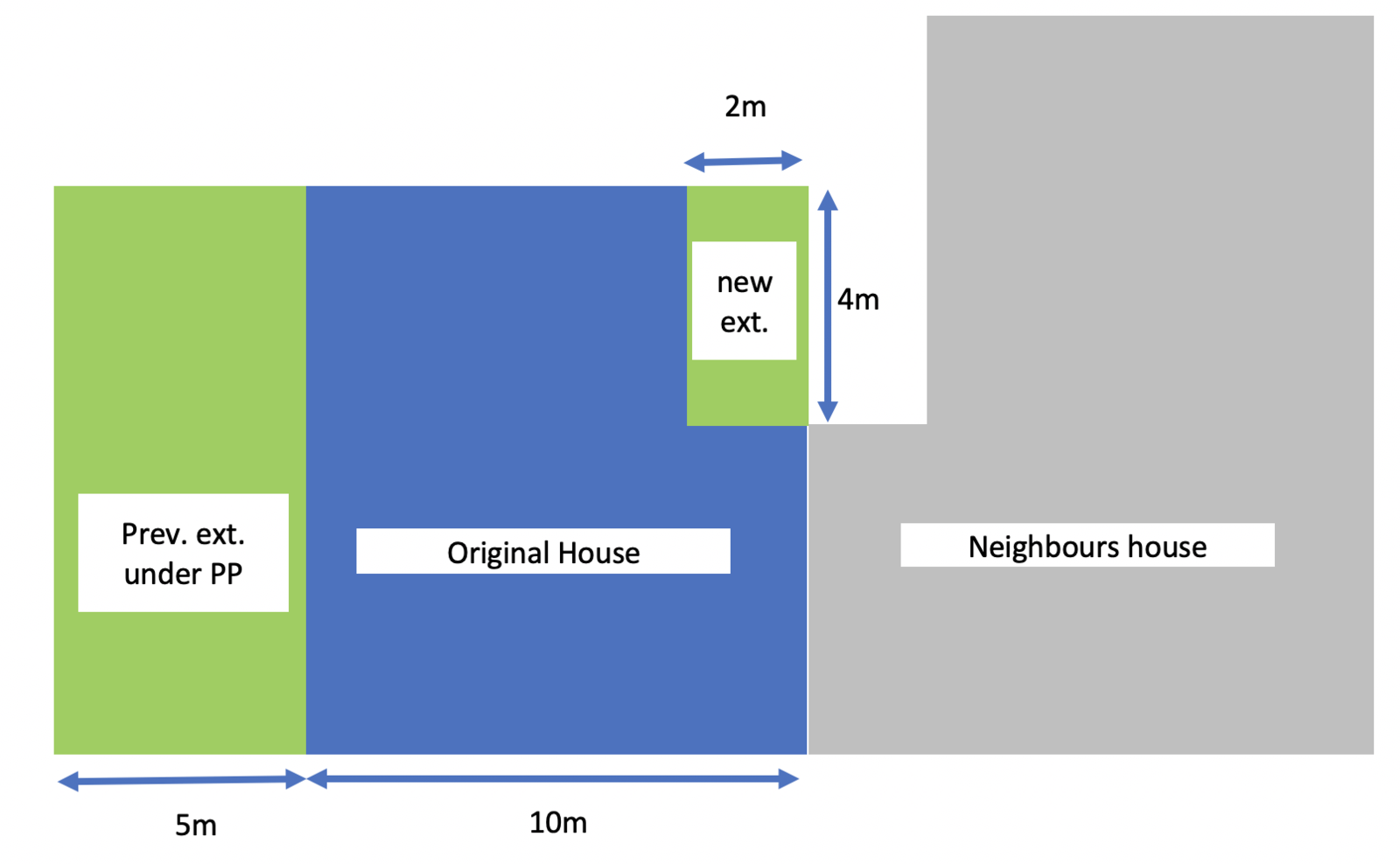

Q: If my house has an existing side extension which is half the width of the original house, can i further extend my house (single storey side extension) under permitted development (PD) to a different side original wall on the opposite side of the house, i.e. can i apply the "half the width of the original house" rule twice against different sides of my house.
-Attached example plans - house is semi detached, original house 1900s and previous ext. under planning permission complete in the 80s
-Both side extensions would be on different sides of the house and from different original walls (therefore not failing the "enlargement" of an existing extension rule).
-I've read the Govt Technical Guidance (Permitted development rights for householders), Section A, (j)/iii on page 22
-------Reference to extension is in the singular (apart from the enlargement clause - which i believe i wouldn't fail) and therefore can i assume the rule applies per extension
It feels like the rules are up for interpretation, is there anything solid or historical examples where a similar project has gained a Lawful Development Certificate (LDC)? If the council rejected the LCD, would an appeal win?
Many Thanks in advance!

Correct and your proposed rear/side/infill extension would be considered PD.
Edit: Unless it’s a mistake on your drawing/sketch, are you actually semi-detached? If so, that rear extension would be limited to 3m without having to go down the NCS.

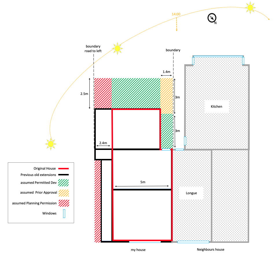

Ive attached a detailed plan of the full picture and overall extension to put into context, originally the question was just about the side of the house as our architect is suggesting that the "half width of original house" is already used up by the previous extensions (on the left in black lines) and therefore cant extend out in between the houses under PD anymore.
  • Original house in Red border, with previous extensions in black - ALL of these are double storey
  • ALL proposed new extensions are single storey only
  • I understand that PA (Prior Approval) would also take into account the slim PD area but have kept them separate for visuals only
  • The neighbour has 2 windows in the courtyarded area, however, both those rooms are large extensions each and both have alternative large windows at either end - does this help?
  • Regarding the direct sunlight, ive checked today and at no point does the trellace fence along the boundary cast a shadow high enough that that covered either of their courtyard windows
  • -------The extension wall along the boundary would be no more that 2m and therefore no higher than the fence that sits there today (1.6m + 40cm trellace - NB: its our fence)
  • The aim would be to build the extension within our boundary and not straddling

The rear extension (green) cannot wrap around to join the infill extension (green/orange)... Permitted Development or Prior Approval and would therefore need formal Planning.
If as you say the left hand side extension (dimensioned 2.4m) is two storey then any extension onto that... single or two storey would require formal Planning, which is what you’ve shown/indicated in red.
I think i get it now, so we could take PA extension right up to the corner of the courtyard (as its over 3m, would need PA to take it the last 1m not covered by PD), but as soon as we go past the corner, the other central rear extension adds the 2 extensions together as a single enlargement and breaks all the rules!

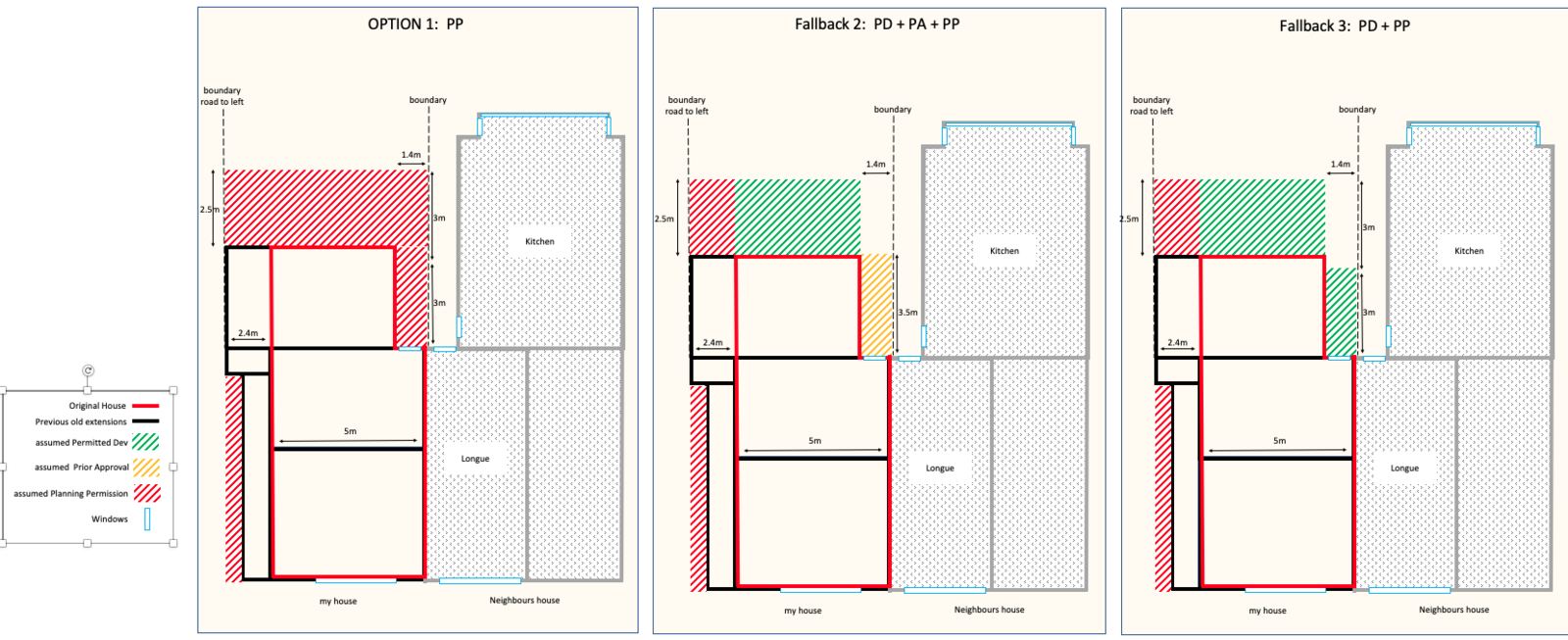

As im a visual person, ive attached the general 3 levels available (appreciate its not boolean and PP can be adjusted etc.) as described in the previous post.
Let me know if i have anything fundamentally wrong, but im hoping i get it now

PD is not always straight forward, which you have realised. What can make it more confusing is that even though most of the PD rules are stated in black and white, some LPA’s do interpret them slightly differently. Although I’ve only had this come up once before and it wasn’t soon after the PD rules changed.
In your example, the large green part to the rear cannot connect to the extended part (in red) on the left as you’d then be using PD on something that isn’t original and would exceed the PD guidelines. If I was you, I’d forget about that rear left extension as not only does it add little floor area, but scuppers your plans for other PD extensions/alterations.
I get your point on the large green rear extension too now.
Whats frustrating is that i would be able to do both the green areas WITHOUT the left red extension via PD and in theory, once that were complete, i would be able to apply and likely get permission (I am speculating...) to build the red extension retrospectively. I say likely only on the basis, it falls within the mirrored PP extension footprint of the adjoining neighbour and there is no neighbour on that side but a road. Is that worth a gamble?
Is there no way the long term vision of the extension can be seen upfront by the LPA but the application/build of it done in one go. i.e. apply for PP for just the red box and carryout the works all together. Can you even go as far to ask the builders to build the red bit last ? :) This is why i think a pre-application with the LPA might sound out their thoughts on having the entire wraparound via PP or understand if its a non starter..
Builders what build what you tell them. They don’t want to or care about the PD or phasing side of things. The PD rules are there to help homeowners carry out minor alterations without PP. They would not relax the rules just because it saves you time or money. Something to note is that if you are looking to combine PD and PP, you should always look to build out and then substantially complete the PD works before applying for PP. This is again a more costly way of doing things, but those are the rules.
Your best bet would be to just apply for PP and cover the whole lot in one go.

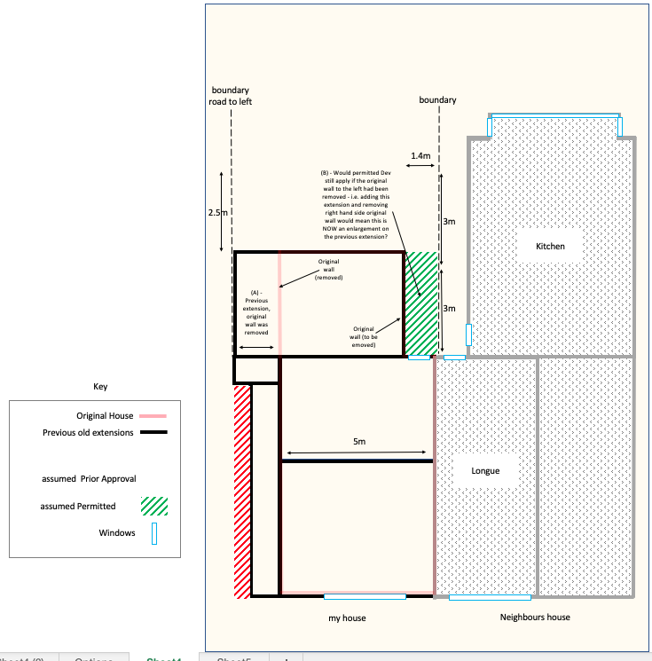

Further thinking, i believe my original drawings were misleading.
Therefore if both original walls were removed by the time the new extension (green area) is built, the overall final extension would be an enlargement of the previous extension (left hand side of back room) as the room spans the width of the entire house, meaning that Permitted Development rules are not met. The only way to meet PD would be for either original wall to remain.
Have i got this right?
