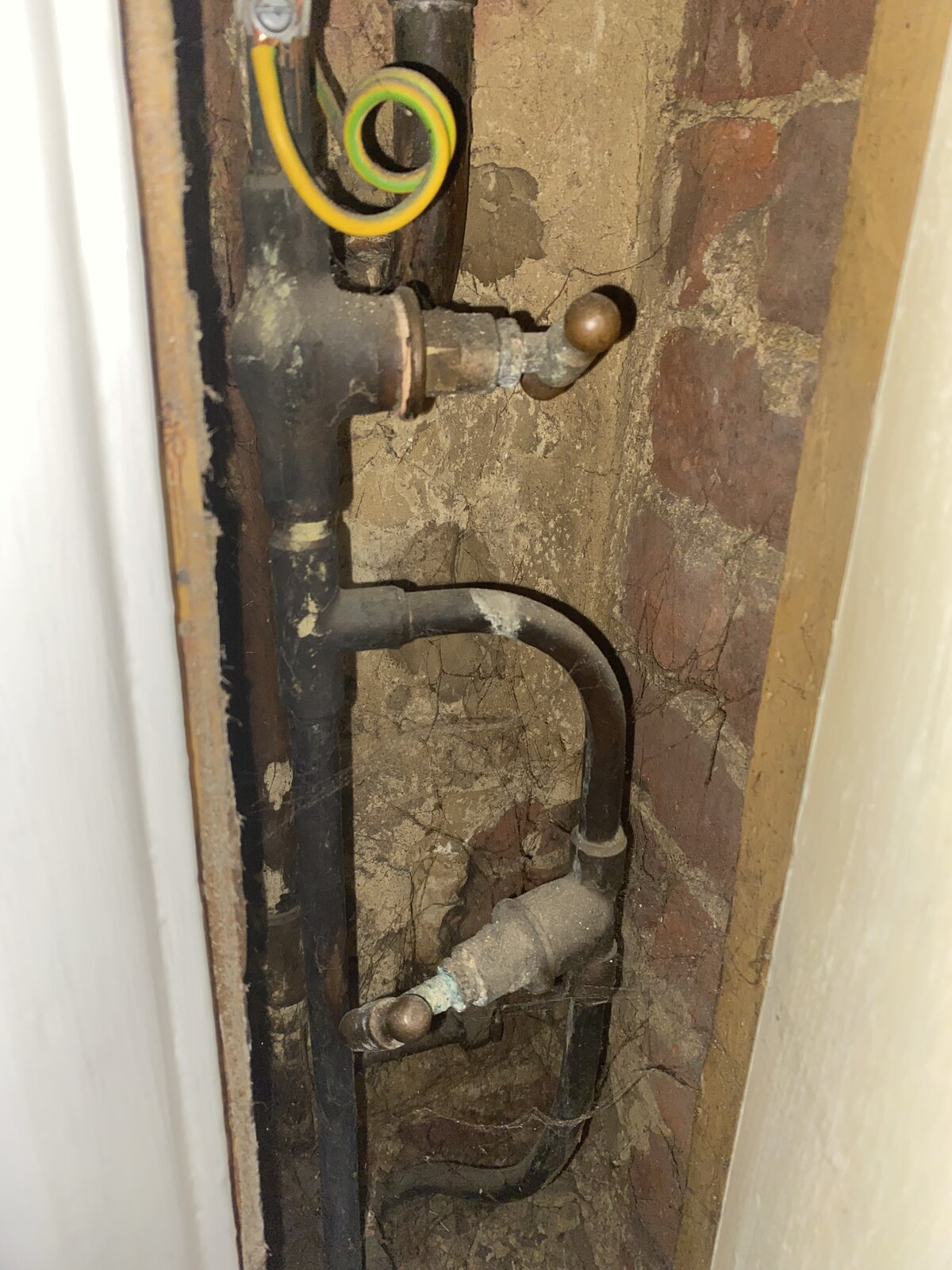

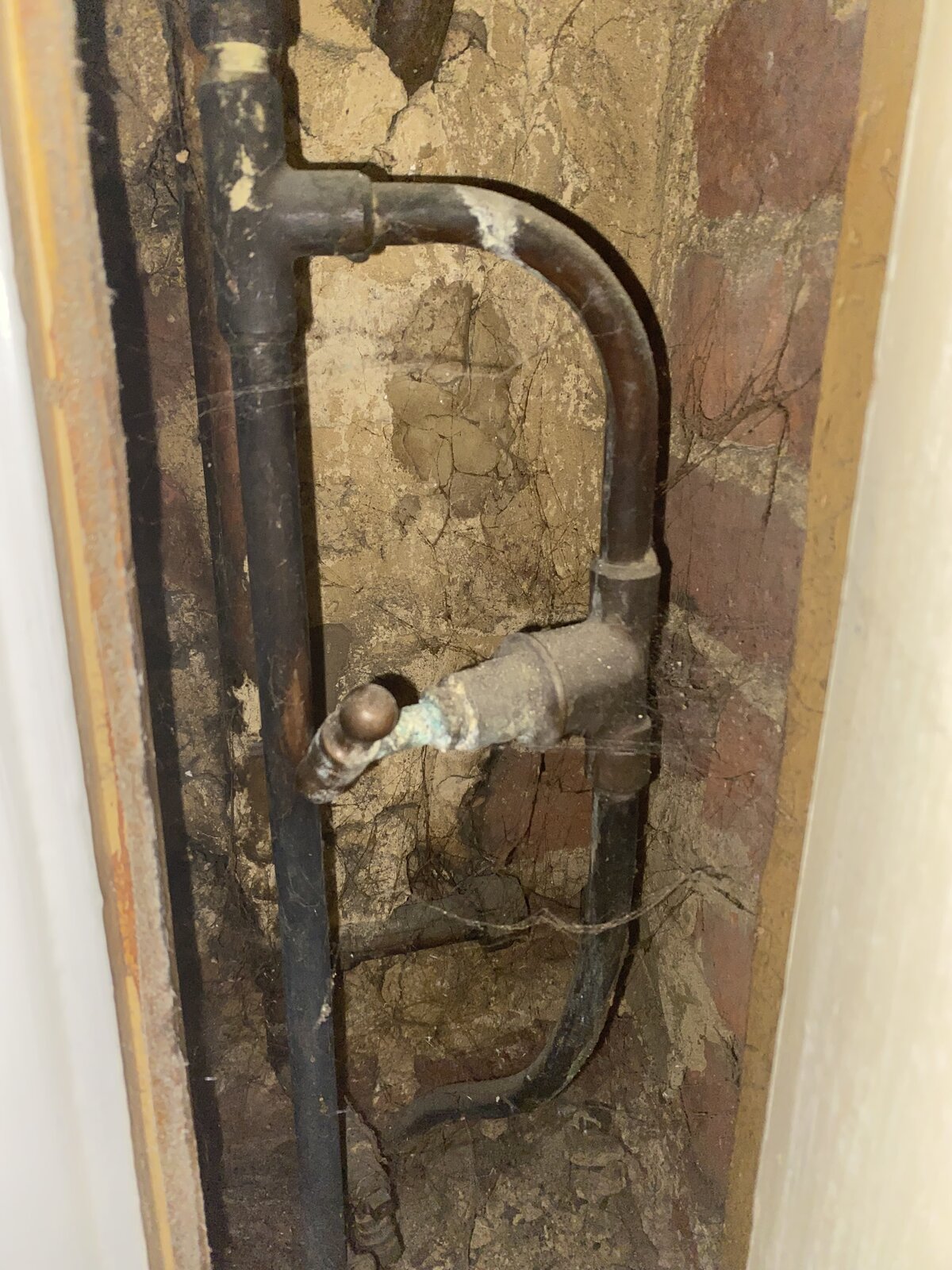

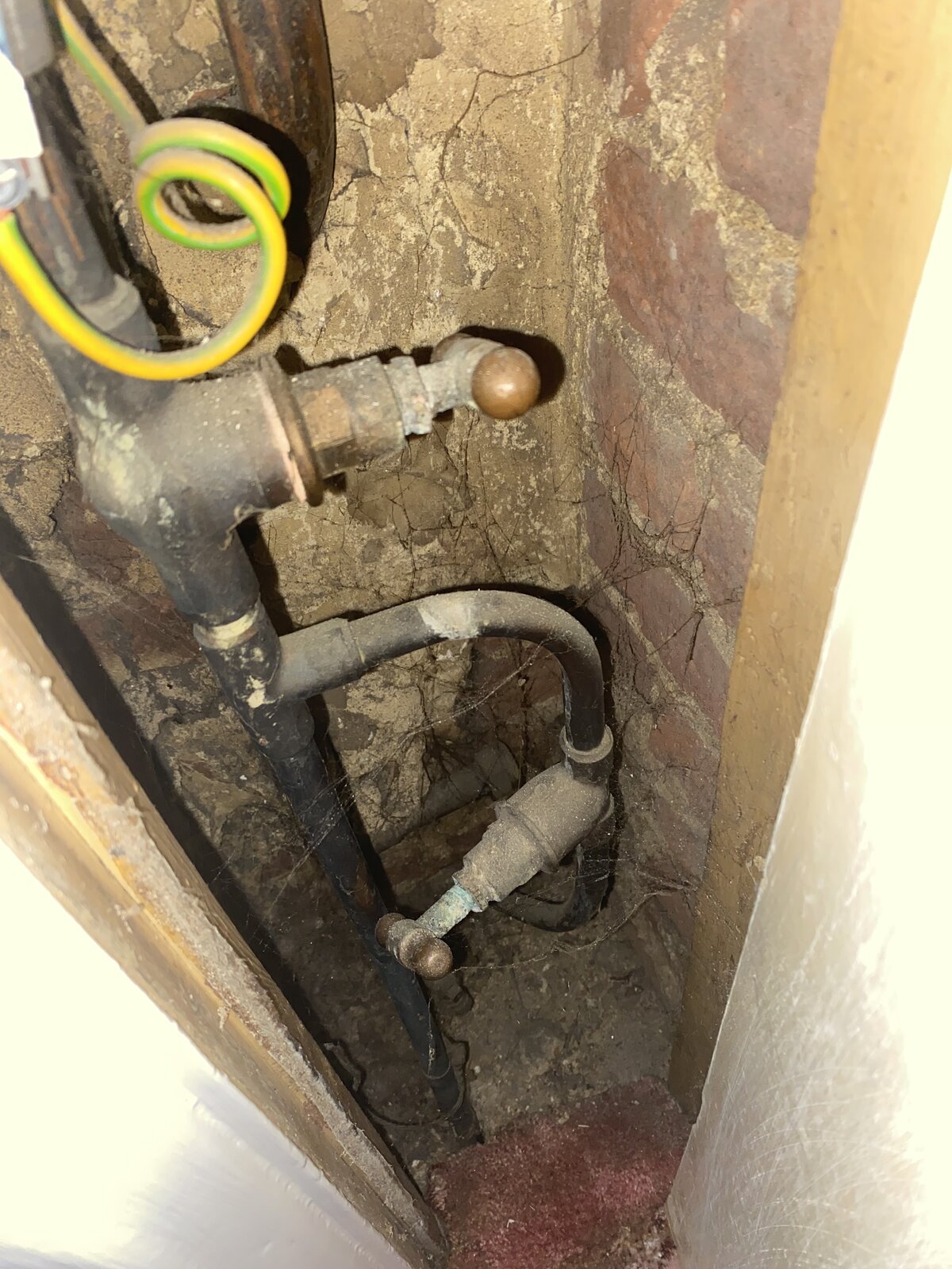

Hi all, I need to replace the stopcock but as you can see from the pictures there seem to be two! Behind the pipes is a chimney breast. Ground floor. Old 1950’s semi.
Any idea what’s going on here?
Glad of any help…

Do you have any other stopcocks in the property, at ground level, where the mains water enters the property ?
One of those pictured may be the primary ,main stopcock ,and the other isolating a branch line.

Mostly wanna know which tap does what?

Could the lower tap be a branch line to the garden tap? Does that sound plausible?
As both pipes appear to disappear into the floor ,it's impossible to tell where they come from ,or go to.
Are you in a flat?
Most likely one stopcock is for one branch and the other one is for another area such as a kitchen..
OP could hold the pipes, and feel which go colder, when various taps are turned on..
Just did this. Worked a treat. The ‘branch’ pipe only gets cold when the garden tap is on, so I’m pretty sure it’s feeding that exclusively.
The vertical pipe comes in at the bottom from the street and goes up to feed the bathroom and kitchen, as well as the ‘branch’.
That make sense?
