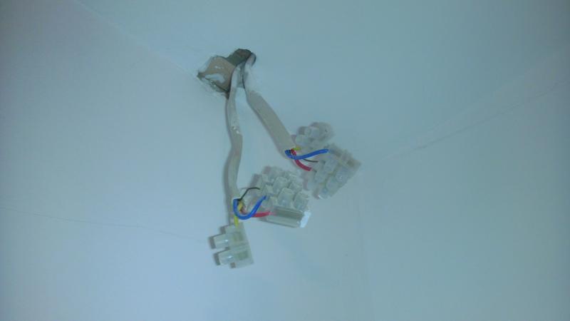

blue`s are actually neutral i connected them together and the two yellows to com
and the two reds to L1
fan works now but does not switch off
i am using the same switches which where there in the first place when they worked
the fan is on a separate circuit to the light
this switch now works
the other one
is connected red to L1 and yellow to L2 neutral blues connected together
i assume either 1 of the red or yellow wires has to go to com ?
after trying various ways
the switch in each room will either switch it on or off , but you can`t turn it off if you have switched it on from the other room.
i give up

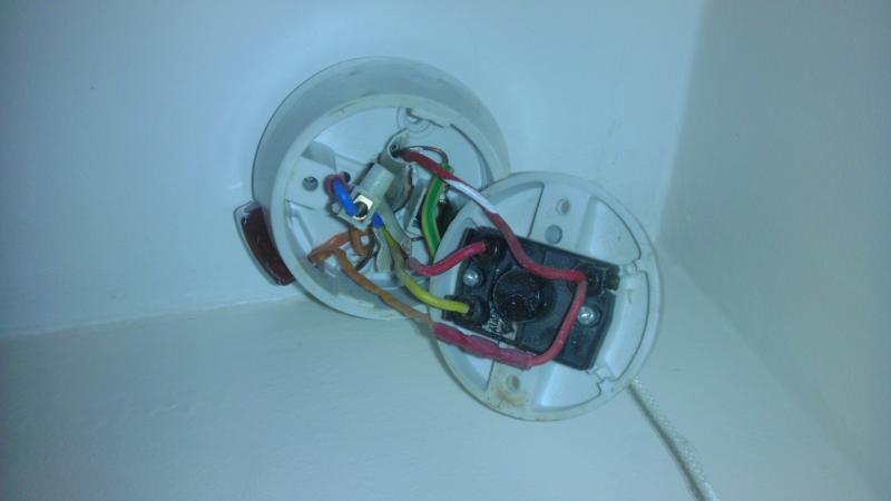

I can't see how it ever worked as you want.
Can you tell us which cable goes where from the junction box.
You have a two-way switch in the second picture - that doesn't make sense.
you need to wire it with two double-pole (not two-way) switches as in Owain's diagram.
this fan is shared between a main bathroom and ensuite , each room had it`s own switch to switch it on or off not via a light switch , i am pretty sure you could switch it on or off from either room regardless which one you switched it on from.
the neutrals are there i think because both switches originally has neon indicators now i only have one fitted with the neon.

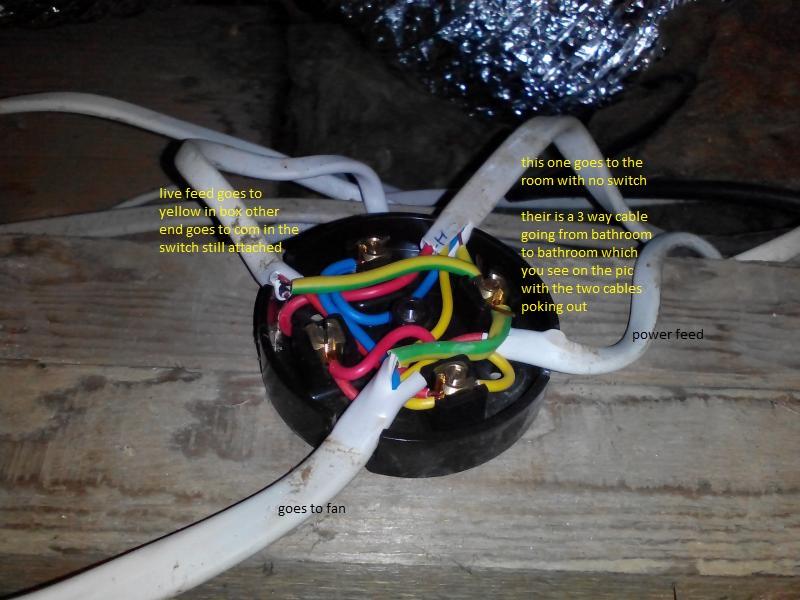

i would assume this is a two way light switch circuit with a fan instead of the light ?
As already stated it would help if you told us where all the cables from that junction box goto.
And also another picture of the junction box from the top.
Where does the fan connect to ? The switch ? and does it have an overrun timer ?

here you go
i dont understand why there is the thinner cable with the neutral disconnected that goes to the yellow cables in junction box and then the com on the pull switch :?
So one cable goes straight from one switch to the other then.
If that's the case.
Connect the blues together.
On the cable that comes from the other switch connect
L1 to red
L2 to yellow
Then on the cable between the junction box and switch connect red to COM. (supply)
The yellow would have been for the neon so leave disconnected.
See if that makes the existing neon switch on and off with the switches.
