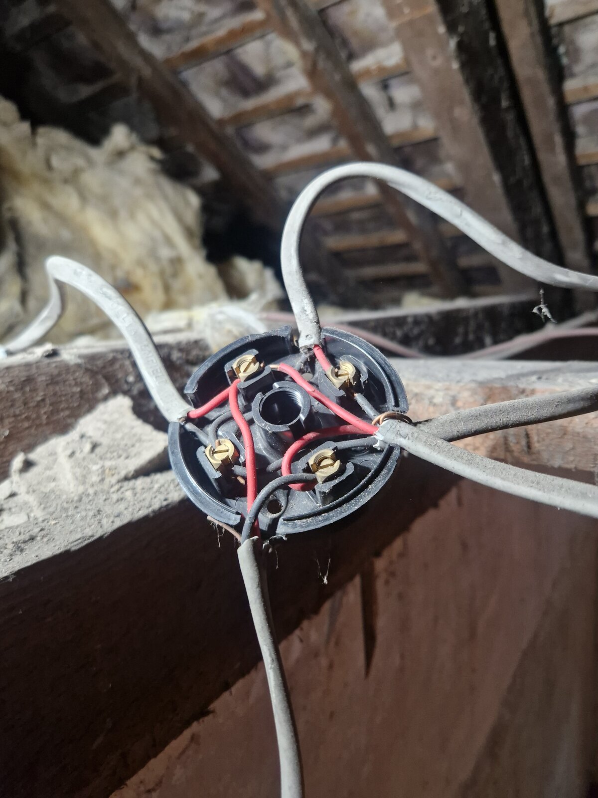

mine at my house the switch live and the common come down on 2 separate cables and the neutrals into a connector block
however in her house its a different setup
there is only one cable at the pendant and one at the switch and then there is junction box in the loft what they go into
there is 4 cables in the junction box i presume supply coming in supply coming out then switchable supply going to the switch which is then linked in the junction box to the pendant
in this room only would i be able to chance this circuit and take supply down to the switch with live and a neutral and then bring it back up with another twin and earth like you would see in a more modern setup ?
pretty much like this

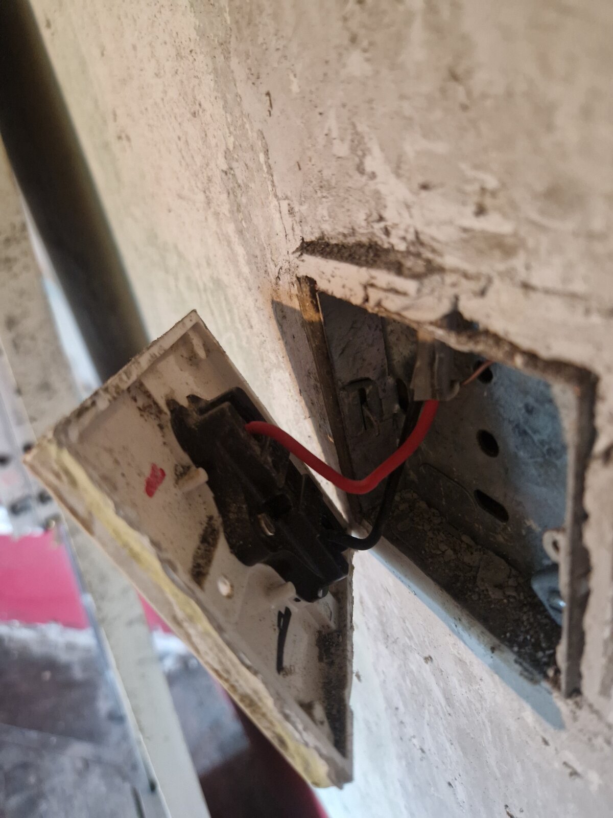

here is some images of what i have so from my view
i have LN supply coming into the box 2 switch lives going from the box one to the switch in this room one to the room next door
and then 2 pendant feeds again on for this room and one for next door
so in the change for the new cable im looking at taking live and neutral from this J box down to the switches then cable back up to the pendants
but i want to add another switch in this room next to the bed so it can be 2 way switch on and off at the bedside and on and off on the wall

why do you want neutral at the switches ????
pete01 said -
Just take a 3 core and earth from the original switch to where you want the new switch
thats the simplest thing

regardless whether is a "new" or "old" layout, best thing to do is run 3C+E between the switches.
If you are going to replace the switch drop, leave it long enough to reach a ceiling rose.
The earths aren't connected in that injunction box, bit of investigation needed and a new junction box...maybe.

Yes the earths are twisted all behind on the back of the box
So yeah 3c and e seems the best option
i was just going with the line of taking N to the switch just to future proof it if any smart switch or something ever ended up wanting to be added
So Working from that junction box what would be my run ?
To the first switch then to the next and the rose like how would it be configure

Change the original 2c and earth switch drop for a 3 core and earth then while you're messing, and fit a 35mm back box or a 25mm box sunk a bit deeper.
