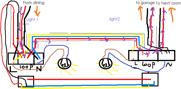

2 way switch issues
Made clearer showing power flow:
I take it there is a red and black cable at one of the switches?
When the lights were working was anything else like a fan being operated when the light was switched.
I would first make sure that all contacts are good with regards to your picture, nothing loose and no insulation trapped.
I think now is a good time to purchase/obtain a multi-meter.
Thanks Freddo, all working now!
I will certainly be drawing a detailed map of the routing for it.
