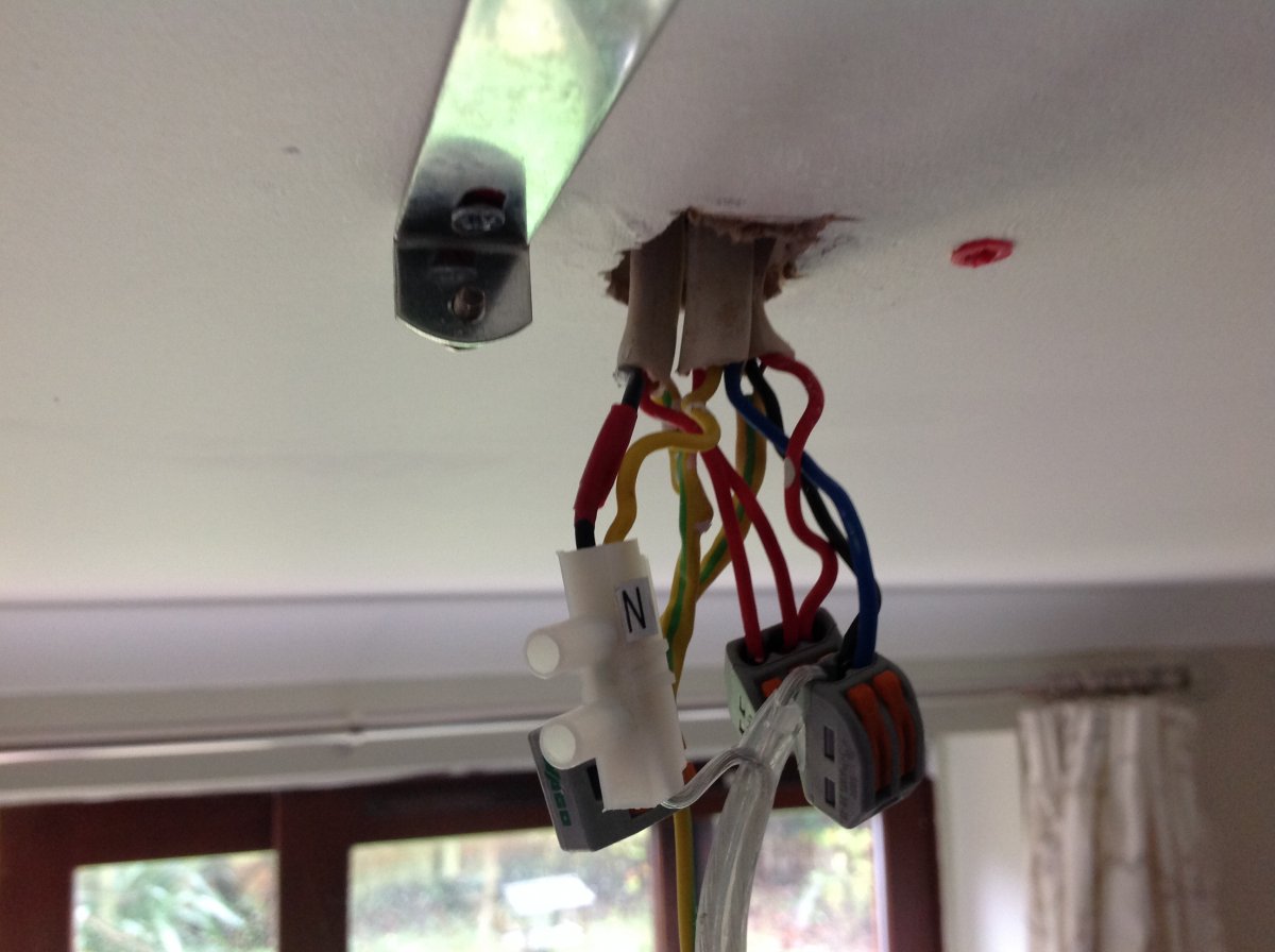

Looking at this, i must have something up the ceiling??? I need two black/two red and a r/b to switch?
Here you go, this is ceiling light one....Second is connected the same.
That looks correct at that light. Are they exactly the same? Including a black wire with a red sleeve/tape around it? If there is no red sleeve/ tape around a black wire then the other light should be different and have the yellow switched live going to the live of the light fitting only. Blue and blacks to the neutral of the light fitting. All reds together in a seperate connector.
That looks correct at that light. The other light should be different and have the yellow switched live going to the live of the light fitting only. Blue and blacks to the neutral of the light fitting. All reds together in a seperate connector.

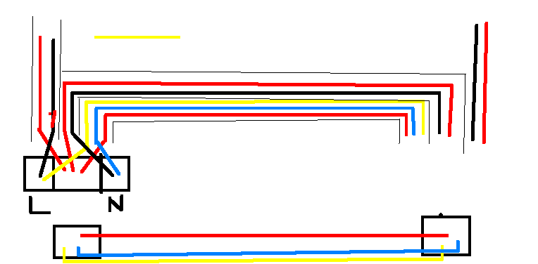

BTW i know this dosen't help but here is the way the first light is connected (i think)...on second rose i've got two black, two red and the 3 core.
Now my thought is the second R+B on the second light rose is next in the ring to my garage (that isn't working?) I've got no switched live coming out to the second light socket

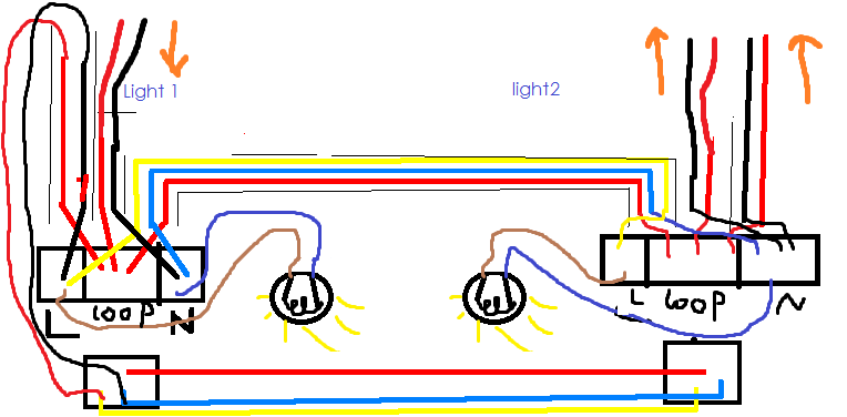

The yellow at the second light will be the switched live:
The orange arrows showing power in and out are just for information as power could be coming in or out of any of the arrowed cables. The cable with the red tape around the black will go to the first light switch as shown in the awesome drawing. I would not expect there to be more than the three core and earth cable going between the lights as there would be no point in wiring it in this way.

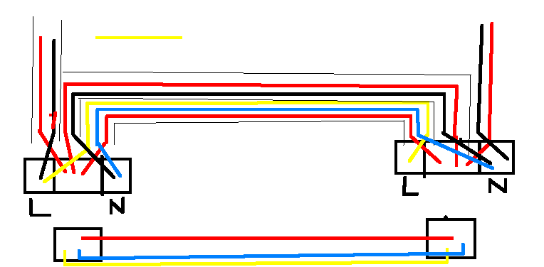

I got this as my suspected loop :)
That would be pointless as there would be 2 permanant lives and 2 neutrals. I am sure there will be no red and black cable between the 2 lights as there is no need for it. One of the 3 red and black cables will be a supply cable the other 2 will be to other lights somewhere else. The red and black with the red sleeve around the black will go to one of the switches. The Red and Blue cables of the 3core and earth carry power through the light fittings. The yellow wire carries the switched live so the second light comes on with the first. Look at the diagram again closely!
