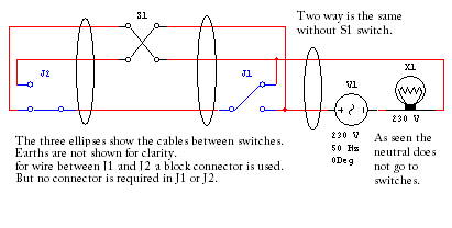

Pictures of all locations may help. In reality you shouldn't be making any changes to what your electrician has done without his approval and direction.
Other than a diagram of the way most two way systems work,
here showing three switches 2 x 2 way and centre intermediate can't really help much more. The standard colours for cables are brown for all, which does not help, so most electricians will use brown, black, and grey, but there is no standard as to what colour is used for what.
As it stands I don't know even the plan, some times we don't use two way as such, but timed switches, and with modern wifi switches there are two wire systems with master and slave set up. And that depends on the make of switch how set up.
