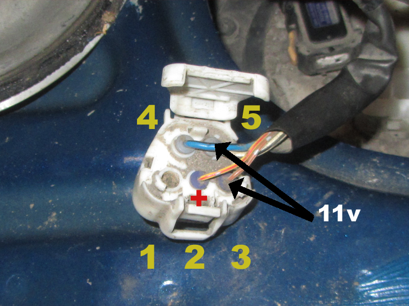

I have a 2003 Rav4 (140,000 miles) that was recently rear ended. (10 to 15 mph collision). It started and drove away from the wreck with no issues. The next morning after dropping off kids, it died in the middle of a busy intersection with no warning. Cranks but hasn't started since.

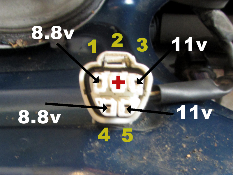

I've pulled the back seat, listened for fuel pump sounds with key on but nothing. Metered the 5 pin connector and have 11v on 2 pins (battery is slightly down from trying to start it). And, 8.8v on the other 2. See pic. Not sure of the actual pin numbers...just there for visual reference.

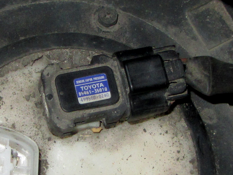

Not sure what the other connector/wires on the pump do or should read. See pic.
Anything else I should check before replacing the pump? I thought I would pull it, air dry it and use a 12v bench test supply to see if it runs out of the truck.

I would think that at least one of the 8v pins should be at earth potential otherwise you only have about 4v across the pump and it won't, work like that, follow the 8v leads and see if they go to earth, if so you have a poor connection.
Peter

Thanks for the replies.
I rechecked everything this morning. Not sure why I didn't check it yesterday but pins 3 and 5 that showed 11v also show continuity to ground when metered to a seat bolt going thru the floor pan. Same when metered together. So, a more accurate way of looking at it is that pin 2 shows 11v when metered to ground.
This morning, I can't get any voltage on 1 and 4 except trace 0.02v readings when metered to pin 2. Looking at the top of the connector (pic), pin one isn't even connected. 3 and 5 still show 11v when metered to pin 2. Same as before.
I've downloaded a service manual for this vehicle but it doesn't have a chapter on the fuel system. Anyone know of a pin out diagram for this connector?
Thanks again,
Mark

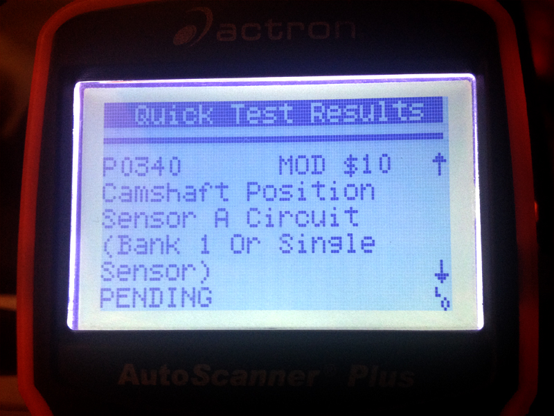

I picked up an rental Actron AutoScanner Plus from Autozone and it showed the following code.
Their PDF of codes shows:
P0340 Camshaft Position Sensor A - Bank 1 Circuit Malfunction
I'm guessing that as "hooked up" as these cars are, it's probably keeping the fuel pump from running as well. Possible? Does this mean it's a bad sensor or the dreaded timing belt replacement scenario?
