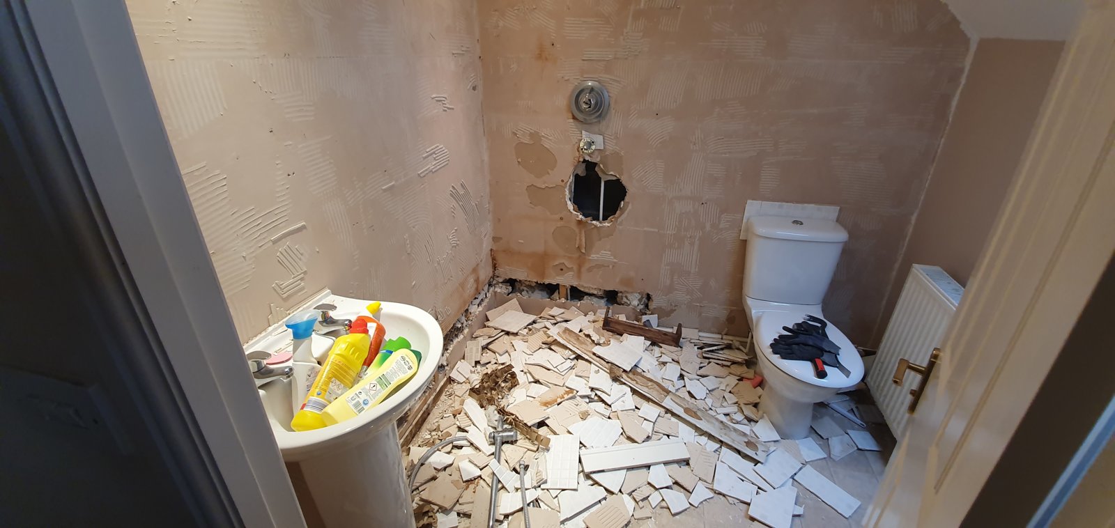

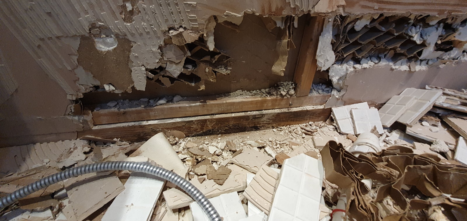

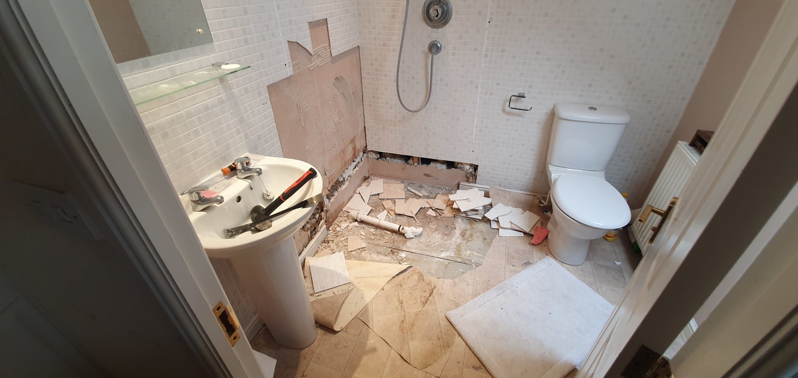

This is just a general interest post. Redoing the ensuite and when I started to take off the tiles, I found they barely had any adhesive at all, to the point where I could pull them off by hand if I'd wanted to. How they have remained fixed at all is beyond me.
There was no PVA and no tanking of any kind in the wet area and as a result, quite a bit of timber has been damaged. The skim has failed entirely in places, as has the grout. To cap it all, the partition (where the mirror is fixed) is paramount board, which is rotten through, as are its wood beams and will all have to be taken down. Floor will have to come up now too and I'm dreading to think what I'll find under there!
The plumbers smashed holes in the plasterboard to accommodate the shower tray and just left it. The tiles were stuck over the top. There was nothing behind the those tiles at all, held together by silicon. I made the circular hole to inspect the soil run, but the rest is as I found it.
This is a Ben Bailey new build from 2005. Over time I'd come to realise they were poor quality builds, but I never really understood just how bad they are until now.

There isn't really any proper studwork, it's paramount board. I've not seen it before. It's basically a cardboard sandwich and doesn't look salvageable. It will have to come out anyway as I want to hang a basin/cabinet unit on that wall and I cant see that existing stuff taking the load, even if it were in good condition.

Using Paramount in a residence is bad practice in my book - its for partitioning offices and commercial areas not houses.
Why do builders use it - speed.
By and large, the Paramount will have to come out causing you lots of extra work.

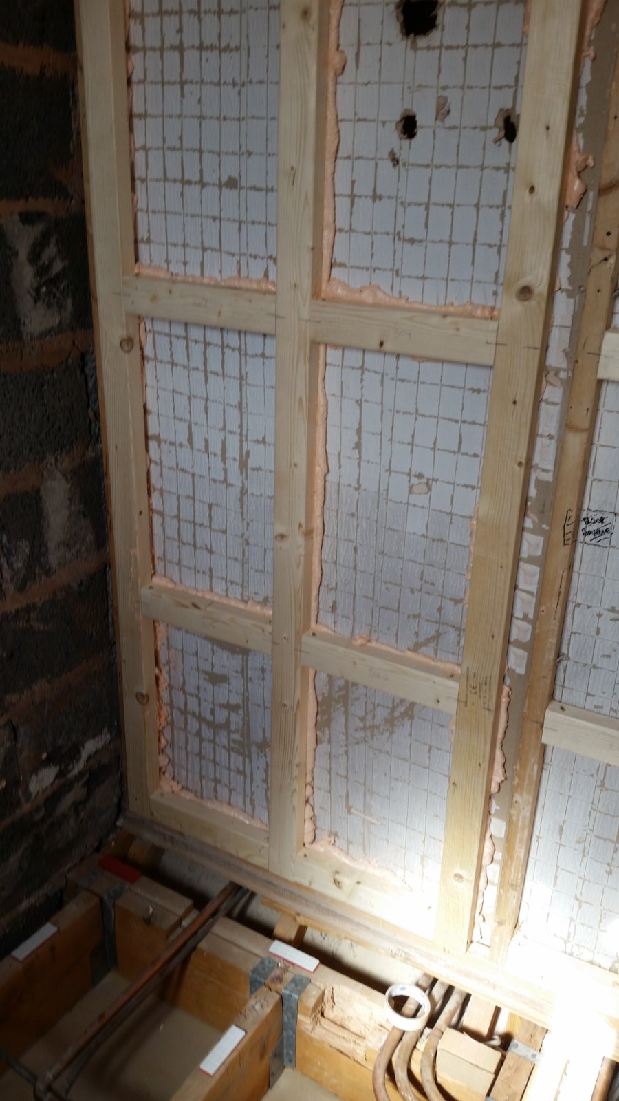

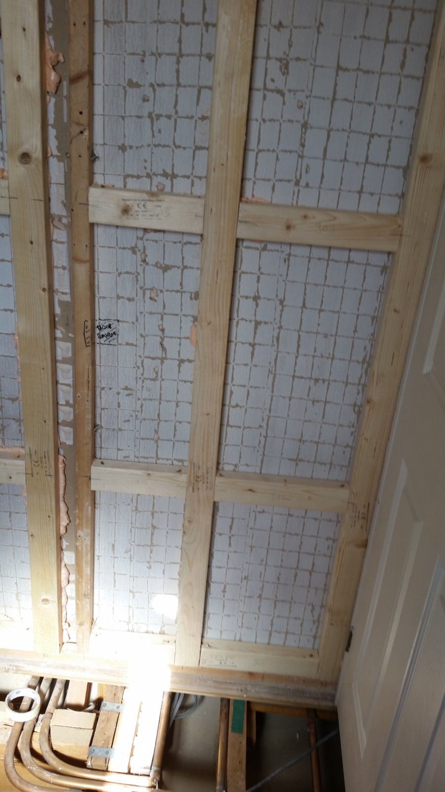

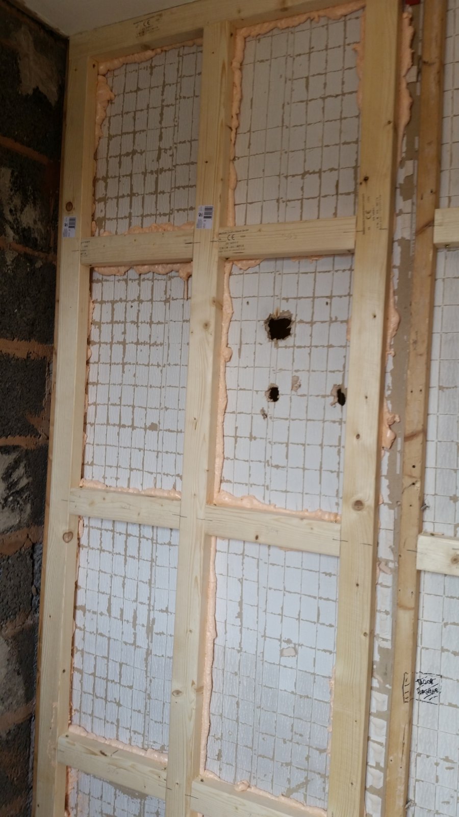

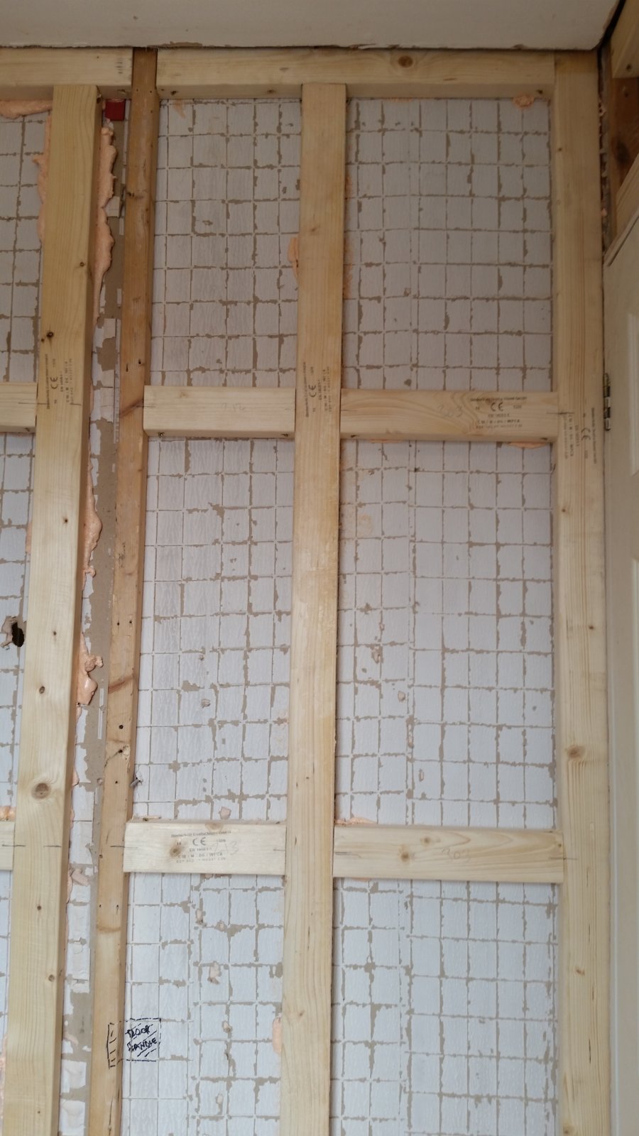

Paramount board is a pain but quite easy to deal with. Remove the plasterboard skin followed by the cardboard honeycomb. Be careful at this stage because the wall will have lost much of its strength. Build yourself a new frame ensuring it's all perfectly flat and plumb and use expanding foam adhesive to bond the new frame to the back of the existing plasterboard. At this stage you can also fix studwork supports of plywood for any new fittings. Board over your new studwork with whatever you've chosen to use. These pictures of a recent one I did might help.
