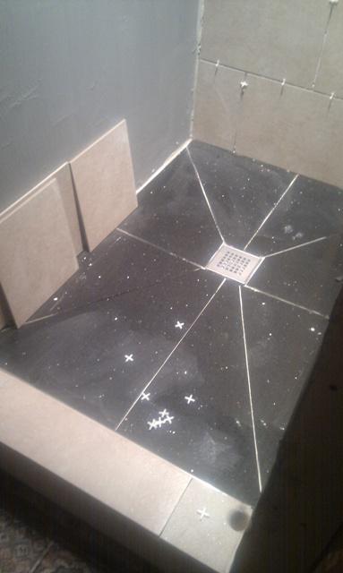

I suppose if I search hard enough I will find the answer to my question, but I need an expert just to tell me. I have recently finished tiling a wet room area and the floor tiles have started to lift. I followed manufactures recommendations and even left the tiles un walked on and un touched for a few weeks before grouting. I used wickes own brand powder tile adhesive to fix the tiles originally. At the moment the tiles have started to lift. I'm not going to re fix them until they are completely loose.
Can some one recommend a suitable high quality floor tile adhesive ( marble tile) and quick quide on preperation and time required to cure before grouting or wetting. Pre annoyed at the moment as I did not rush this project and up until today things where looking good.

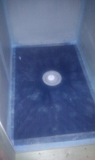

Thanks for the quick reply. The floor is basically original joist (300mmm centers cant remember dimensions, 1920s house) which have been cross spanned with 100mm x 50mm joists at 250mm centers. This has been over boarded by 18mm MDF. This is overlayed with a Wickes Wetroom base which covers the full area of the shower floor. The floor feels really solid to stand on and doesn't seem to stress in any direction.

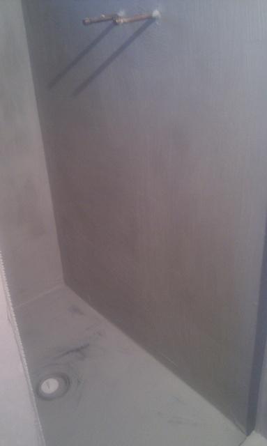

The whole room was then sealed with Bal Primer and jointing tape. Then again the whole room was then tanked with 3 coats of Bal Wp1 Tanking sealent. I have had no leakage problems just failure of tile adheasive below floor tiles.
The wetroom has been in use for about 8 weeks with around 4 weeks prior to this setting time after fixing.
Hmm, the only mistake you seem to have made is in the use of MDF. Chipboard is bad enough but that stuff is even worst, a big no, no even if it’s being covered up, it'll just evaporate if it gets damp; always use WBP, seal the back & edges with acrylic primer & screw through into the joists every 150mm. Wet room base formers must be fully supported, 8 weeks is a pretty rapid failure but if you say there is no flex & you tanked with BAL WP1 then my suspicion turns towards the addy/grout you used or the way you laid it. Having used BAL tanking, why on earth didn’t you use BAL addy - either Natural Stone, SPF or Rapidflex + Supaflex grout; it’s always best to use quality products from the same stable. Was the Wickes stuff flexible? Was it suitable for Marble? What type of trowel did you use? - a thick bed solid bed trowel with 20mm round notches, 10mm deep, at 28mm centres or the tiles won’t be fully supported. How thick did you lay on the WP1? Did you prime it with anything before tiling?
