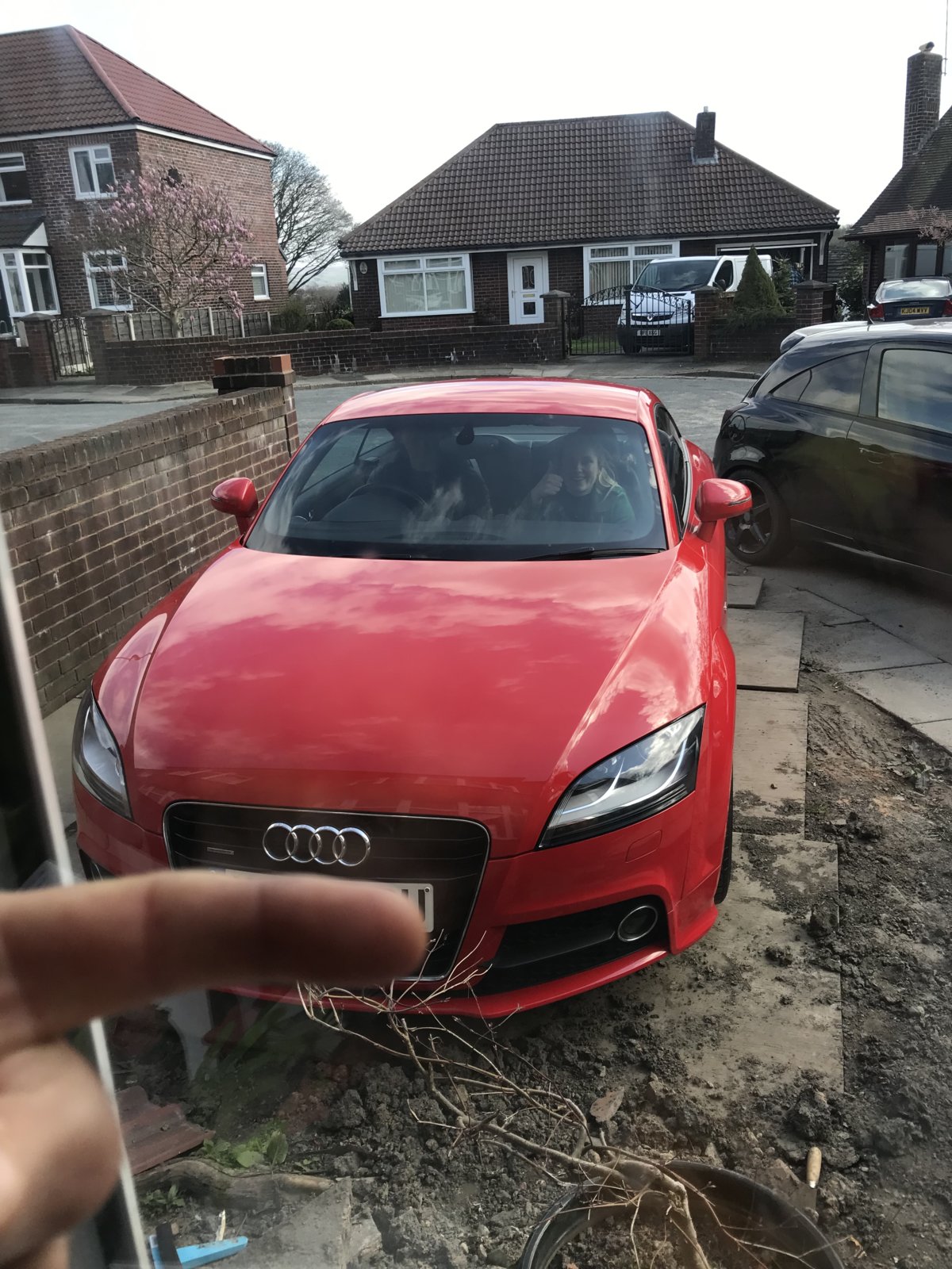

She bought it, it’s a 168bhp engine, 48,000miles, full service history including the 4x4 oil being done.
Need to get the driveway done now!!
She bought it, it’s a 168bhp engine, 48,000miles, full service history including the 4x4 oil being done. Need to get the driveway done now!!
I suppose you’ll be making that her next job then! :LOL:
Sorry mate, got in my mind it was an A3 for some reason :confused:
John :)

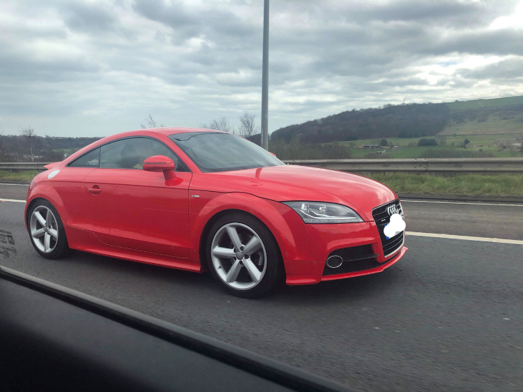

An easy mistake to make (y) They all look similar from the front, she took a pic of me driving it back:
The only thing I don’t like are the wheels, when she is due tyres I will suggest swapping them for some other TT ones
