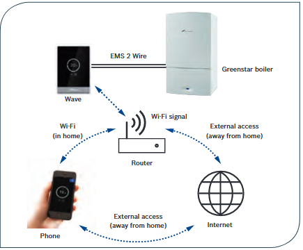

EvoHome will work, but EvoHome is OpenTherm and many Bosch boilers don't support OpenTherm so you may be better off with Wave which is Bosch's own system using the eBUS connection.

I would have to use a Wave smart control as have a Worcester boiler which does not support OpenTherm so have to use their thermostat or nothing. I had originally intended to use Nest, which will using IFTTT talk to the MiHome Energenie TRV heads, but since Nest is OpenTherm and boiler does not support that never bothered.

As said would be better with Wave smart controls which modulate the boiler, but £240 price tag is a little off putting, plus would need some hard wiring in to the boiler bus. I looked at Wave Instructions
The lovely picture shows the problem, no connection with the TRV heads, OK at my house where a single thermostat can control whole house yes, but my boiler is not modulating, in mothers house really a waste of money.
