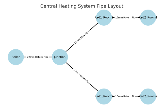

So based on the feedback Ive decided to do some calculations. I must admit, Ive had 6 houses over the years, and had the heating system either installed from scratch or by qualified plumbers. I must have had 10+ rads added to the systems at various points too..... honestly, I dont think ive ever seen a plumber perform any kind of calculation, and when adding rads on I dont think ive seen them do anything other than feeding off the nearest 22m, down to 15mm all the way to the rad.... Ive defintly not seen a calculator out.....and ive never had any issues. However, as this is being done from scratch, and Im doing it myself (apart from the comissioning) I thought Id plan it out properly;
Its a build seperate to the main house, with its own 30kw boiler. Its 2 rooms, both on the same level.
Room1 will have two radiators, both 5849 BTU rated.
Room 2 will also have 2 radiators also rated 5849 btu.
radiator 1 in room 1 is 3m away from the boiler.
radiator 2 in room 1 is 7 meters from the boiler.
Radiator 1 in room 2 is 10m from the boiler.
radiator 2 in room 2 is 15m from the boiler.
Each radiator is rated at 5849 BTU.

Total heat load for the system:
11698
BTU
11698
BTU
23396
BTU
11698BTU+11698BTU=23396BTU
Boiler to Radiator 1 in Room 1 (3m):
I believe 15mm pipe is sufficient since it can handle up to 15000 BTU/h, and the load is 5849 BTU.
Boiler to Radiator 2 in Room 1 (7m):
The total load up to Radiator 2 will be 11698 BTU. So15mm pipe
Boiler to Radiator 1 in Room 2 (10m):
The total load up to Radiator 1 in Room 2 will be 17547 BTU (11698 BTU from Room 1 + 5849 BTU for Radiator 1 in Room 2). So a 22mm pipe here because a 15mm pipe would be too close to max.
Boiler to Radiator 2 in Room 2 (15m):
The total load up to Radiator 2 in Room 2 will be 23396 BTU. So A 22mm pipe.
Detailed Pipe Layout
From Boiler to Junction for Room 1 and Room 2: Use 22mm pipe.
From Junction to Radiator 1 in Room 1: Use 15mm pipe (3m).
From Junction to Radiator 2 in Room 1: Continue with 15mm pipe (total distance 7m).
From Junction to Radiator 1 in Room 2: Use 22mm pipe up to the point before Radiator 1 (10m), then reduce to 15mm pipe to the radiator.
From Radiator 1 in Room 2 to Radiator 2 in Room 2: Continue with 15mm pipe (total distance 15m).
Summary of Pipe Sizes
Boiler to Split Point: 22mm
Split Point to Radiator 1 in Room 1: 15mm (3m)
Split Point to Radiator 2 in Room 1: 15mm (7m)
Split Point to Radiator 1 in Room 2: 22mm (10m), then 15mm to the radiator
Radiator 1 in Room 2 to Radiator 2 in Room 2: 15mm (15m)
Plan
Ive done a little plan as follows
Be interested to here is you guys think this is ok.
Yeah, your use of BTUs which haven't been the standard measurement for heating power since the 1970s was somewhat off-putting. All my charts & calculator are in watts and I couldn't quite work up the enthusiasm to convert all your measurements across when I saw your post late last night. Might get time to look at it later for you.
