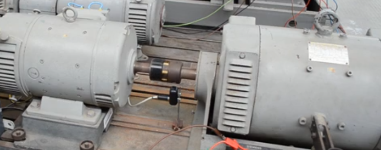

There are a number of ways to convert single phase to three phase, including motors with capacitors fitted and large flywheels.
There is nothing to stop you having a single phase motor driving a generator, what is shown is actually part of a ward leonard system, but well before static inverters we had rotary coverters, the advantage of the rotary type is it has mass, so when you connect a large load the lights don't dip to same extent.
However the big question is one large inverter or many small, using a static inverter gives one some extra options, a small 230 volt delta / 400 volt star motor in delta connected directly to an inverter allows a large amount of speed control and reduces the inrush.

... the advantage of the rotary type is it has mass, so when you connect a large load the lights don't dip to same extent.
True, but I suspect that they might well 'dip' when one first switches on the motor.

And then there's the inefficient transfer of 1Ph electricity to motor motion followed by the motor motion to 3Ph electricity generation followed by transfer to motor motion.
Indeed, you're going to have a lot of heat and some noise here, I recon 75% efficient at best. So for every 1kW of 415V 3-phase out, you're going to need 1.33kW of 230V single-phase in. Therefore to run even the smallest Machine Mart screw compressor (5.5HP) you need 5.6kW supply - with a starting power up at 17kW. That's a dedicated supply from your consumer unit, you can't plug it in to the ring final.
