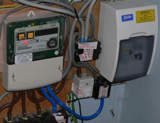

Spark123:
a question based upon the above (and the attached picture)
First, I can see the purpose of the neutral switch line to the off peak contactor but there is a second connection to that output terminal from the meter.
It goes from the meter to the neutral terminal (Henley?) block sited just below the bottom lefthand corner of the Sector CU, ie the same block as the neutral from the meter.
The only other connection to that block goes up to another block, immediately left of the Sector CU, and is the connection point for all other neutrals AND anything supplied by L2 - which is the domestic CU and the TP heating unit
That meter has only been there a couple of months, so I'd guess re-connected deliberately. Is it/was it for some other switching signal purpose?

Spark123:
PatsPatter
I'm not 100% sure with this but likelihood is the meter has a relay in it (with dry contacts*) for the off peak switching so when the off peak is active the relay is closed thus completing the circuit. The link to the neutral block will complete the circuit.
The advantage being with dry relay contacts the type of meter can be used (by the supplier) for various differing purposes and they don't need to stock loads of variations of them.
Maybe someone who deals with meters can confirm?
