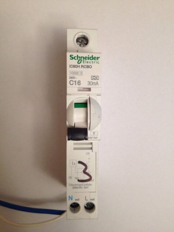

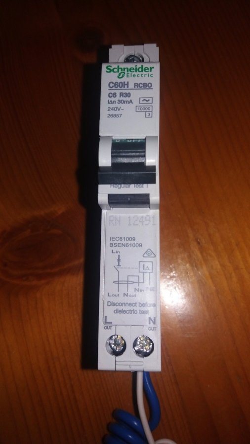

If you shop around well enough, you can pick up schnieder RCBOs for MUCH less than the list price.
eBay is great, if you're careful. Only go for new ones, ………………...
Make sure if you go that route to only buy the new style (with the curved white is test button around the toggle) or the old style (with a grey test button under the toggle) it'll look proper gash if you mix the two
Got that, ta.
As you say a quick look at fleabay brings up lots - both this (older?) type:
….and this (newer?) type:
As you say, it'll look pretty gash with them mixed…………….. and I've already got plenty of that in stock :(
PatsPatter
Go with the newer ones. I'm not 100% sure the older multi9 breakers and RCBOs properly fit the new acti9 boards.
Have not tried old Rcbos in the new Acti 9 boards.
Due to the fact, the old style are obsolete, we do have problems fitting the new rcbo,s in the older boards, mainly they dont seem to clip in right, though occasionally do fit.
physically the fitting looks identical, so it seems odd, we recently reused the mcbs in a damaged board and the old style mcbs fitted the new board fine, the issue seems only with the rcbos.
So yes I would agree that its possible you could have rcbo problems
As per others id get the latest cream colour ones so all looks neat
Also , im not sure you intended to, that them ones in the pic fit Easi 9 boards and only fit the Acti 9 boards
Thanks for the warning.
The images I used were just to illustrate the difference between the two types, after reading/responding to iggifer's post - and they're second hand to boot. Not the route I'm going.
