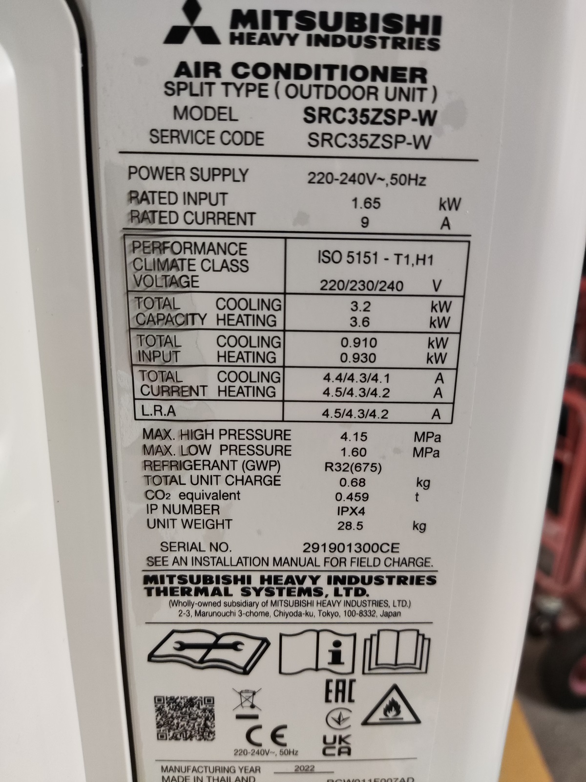

25a Appliance on Unfused Spur off 2.5mm ring final with 32a RCBO
I know ideally it should have a dedicated radial 25a rcbo/mcb in the board but wondering how bad it would be to run a spur off the existing ring. Instructions say "over current 25a" and you can see the plate (and what the device is) below....

13 amp max spur from a ring main, its supposed to be evenly loaded sticking 25 amps on one point may overload a leg.
See appendix 15 of bs7671, recommended items over 2kw have there own circuit
Thats not a 25 amp appliance its 9 amps, even so it need it's own supply if you want to do a proper job
Thanks a lot for the reply. I haven't got the full bs7671 and I'm not an electrician (hence asking on DIY site) but I do have the on site guide 2018 which in section H2.4 doesn't seem to say unfused spurs are limited to 13a ? Although section H2.5 does talk about it.
The plate seems to suggest the average usage is 9A but could peak a lot higher (presumably why the instructions talk about 25A over current)
I dunno bit of a nightmare if I have to run cable round the building just for this.
Ahhh hang on. Yes as you say its 9A - the other figures are output. So this could be put on a 13A fused spur I believe? Although strange why the insutrctions talk about 25A over current.

Ahhh hang on. Yes as you say its 9A - the other figures are output. So this could be put on a 13A spur I believe? Although strange why the insutrctions talk about 25A over current.
Yes you could use a 13 amp spur on this occasion
I don't even know where you get 9A from - does it not say 4.3A at 230V or 4.1/4.2A at 240V? What am I missing?
Kind Regards, John
It says 9 amps at the top of the unit/rated current
So it does, and also says that the 'rated power' is 1.65 kW - but what do they mean, given that the bits below give the total input as 0.91 or 0.93 kW and 'total current' as 4.3A at 230V ?
Whatever, I think we can probably agree that, at least current-wise, there's no real problem in it being on a spur from a 32A ring?

Yep, I'll go with that mate
