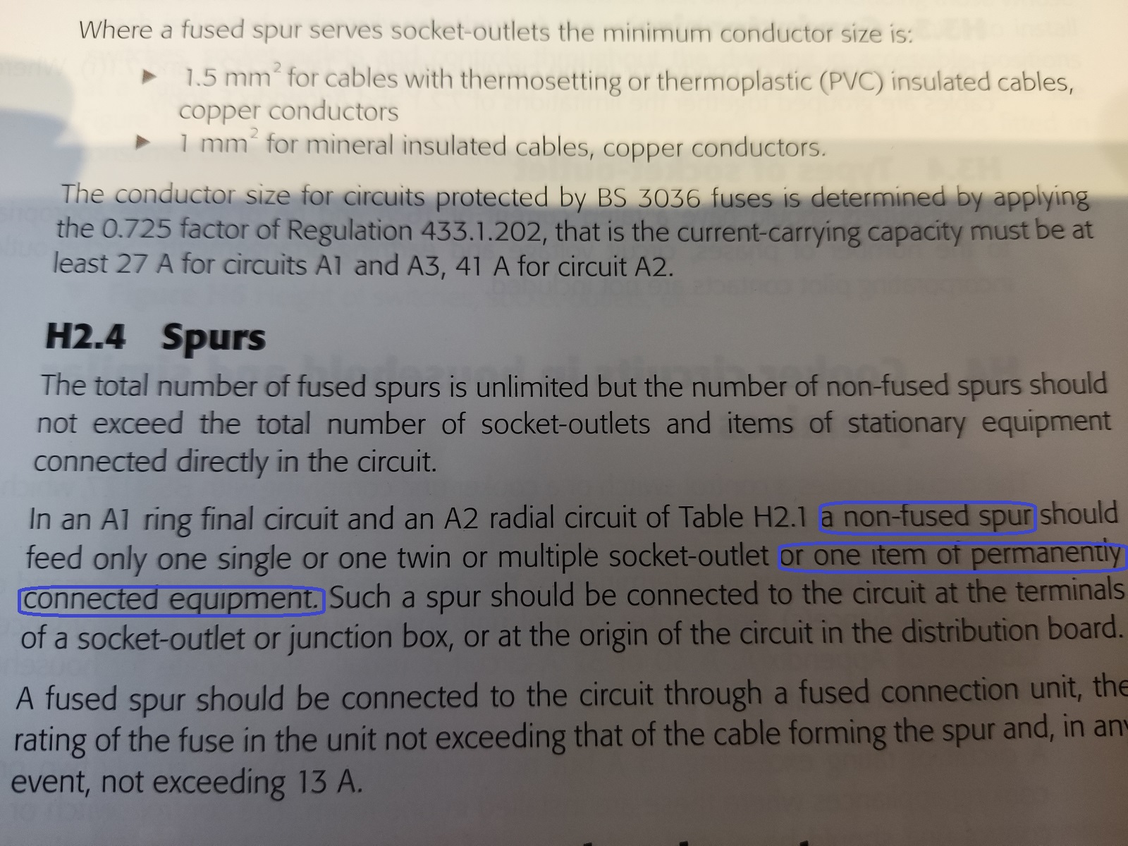

25a Appliance on Unfused Spur off 2.5mm ring final with 32a RCBO
I would have said 25 amp for inrush, although most fixed AC's use inverter drives so there should not be an inrush. I noted most fridge/freezers said do not use an extension lead, this was due to the volt drop on start could cause the motor to stall, yet even with the inverter drive models it still says do not use an extension lead, so the 25 amp could be a throw back from earlier models.

Personally in the OPs situation, I'd feed it from a switched fused spur, with a 13A fuse fitted and likely 1.5mm cable assuming a short run, I'd also make sure that if the circuit was on a type AC RCD that it was upgraded to type A. (I normally roll my eyes a little at those who insist on an upgrade when a minor addition has been made to a cirucit, but here, we are adding a sizeable inverter drive to a circuit feeding socket outlets. So quite high up on the list of things which 'could' blind RCDs, and also sockets quite high up on list of things that you want to avoid blinding of RCDs on)

Interesting discussion.
It would certainly be quite easy for me to add in a fused connection unit for that particular appliance.
I do wonder what this means in the guide though. If non-fused spurs that are fixed appliances are allowed what is the problem? By the way, the instructions do specify 2.5mm and rubber (well h07rn-f or similar). Maybe that's the reason it wouldn't be allowed? (2.5mm t&e through a wall would likely be just too thin for a 32a mcb/rcbo although splitting hairs its maybe not that bad....although as I said putting in a 13a FCU could easily be done but a worry about the 25a) SO seems like the only fully compliant method would be to run a single radial from the board protected with 25a rcbo)

.... If non-fused spurs that are fixed appliances are allowed what is the problem?
I personally don't think that there is any problem.
If it has a CCC of at least 20A and a CSA of at least 2.5mm² (1.5mm² if MICC)) it would be 'allowed' (as an unfused spur from a 32A ring), regardless of what insulation it had.
As above, 2.5mm² appears to be allowed for an unfused spur from a 32A ring final (although, not for a 32A radial), provided only that installtion method is such that CCC is at least 20A.
I'm really not sure where (the thinking behind) this "25A" comes from.
