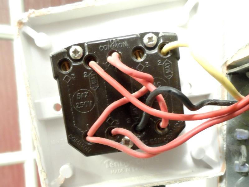

Hi all,
First post on here and, with apologies for asking what many may have already posted, I have bought a Volex black chrome fronted 3-gang switch to replace the existing Tenby unit. Naturally, the labelling and connections are entirely different in both switches, leaving me suitably lost. Other than unscrewing the original plate from the wall, I've not touched any wiring.

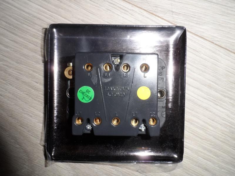

Where the existing Tenby unit has five connections, labelled 3-2-1-3-2, across the top and four connections, 1-3-2-1, on the bottom, the Volex unit has four at the top, L-L1-L2-L and five at the bottom, L1-L2-L-L1-L2. There is also the earth connection on the Volex unit. As it has a metal surround, I presume I should connect this to the main earthing point in the plaster depth box.
Photos attached.
Can anyone please point out which I should connect to which? Thanks.
Steve

I can see no earth connections on the (plastic) Tenby unit. I presumed I would simply connect an earth cable from the srew plate on the switch into the depth box connection. Not right?

All you need to know is that each individual switch on the old plate has three terminals each - 1, 2 and 3.
And each individual switch on the new plate has three terminals again - only marked differently - L, L1 and L2.
So;
1 = L
2 = L1
3 = L2.
Observe on the backs of the switch plates how it's sectioned off to show that each individual switch has three terminals.
