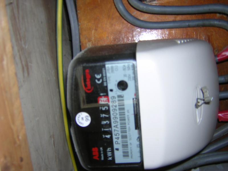

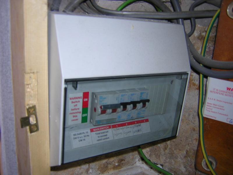

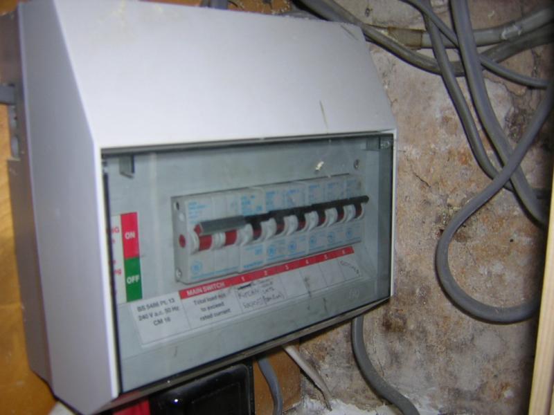

there's two fuse boxes.
[sarcasm]Oh well in that case you have a 3 phase 400 volt 50Hz 160 amp supply. You have 12 circuits, three of which are ring finals, three lighting circuits. [/sarcasm]
PLEASE GIVE US MORE TO GO ON!
A photo would be perfect! You can upload to this forum.
four photo's in the last message. one of the photo's is of aMetabo table saw for the same workshop
