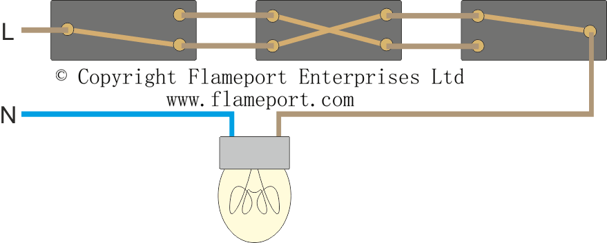

Just had a proper read through of your description and the diagram (I've never used these in a three-way setup)
But, from your description, it sounds like you have the live feed into the switches at the double, and the switch wire out to the lights at the last switch. As per this diagram (Switch on the left is your double, then the intermediate, then the last switch).

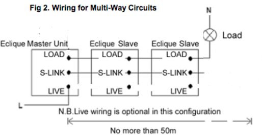

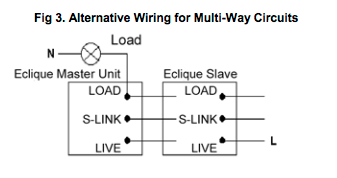

But the varilight instructions require a 3-core strapper if the live and switch live are at different switches, you only have two.
Maybe someone will correct me.
It's not obvious to me if the two figures you've quoted are the only two ways of wiring them, or if they are just two examples. Why would it not work if connected like figure 2 but with the load connected at the other end of the chain?
Presumably the master dimmer is the one with all the complicated 'lectronics in it, so the load must be connected to that.
Then your (for examples sake, we'll use R&B) black, takes your load from switch one to switch 3.
Your red then has to take your live from switch one to switch 3.
Then there is nothing to connect to your signal link between the switches.
Like I say, I'm not 100% but there must a be a reason they put both diagrams in
Yes.
Doesn't follow.

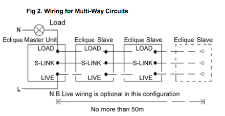

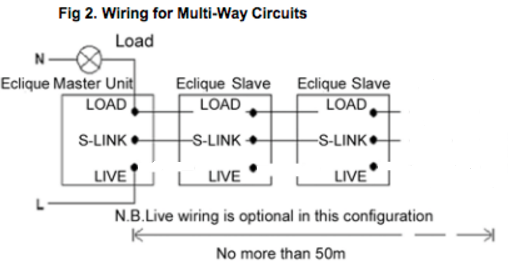

thankyou for trying to help me with this! do you think I need another wire to connect the S-links together then? after first seeing the diagrams I thought that, but was not sure what to do with all the other red,black wires or whether they were live or neutral!
All the conductors connected to the switches are Line(live).
We are unsure about whether an extra wire is needed.
However, if it works like this - as the instructions state:
then I can see no reason why it wouldn't work like this:
You can try it before causing damage to put in another cable.
Let us know how you get on.
so looking at that I would just put 1 live (I presume red) into 1st (master) then in the other two just have neutral (I presume black) through the load, but how would I connect the s-links?
