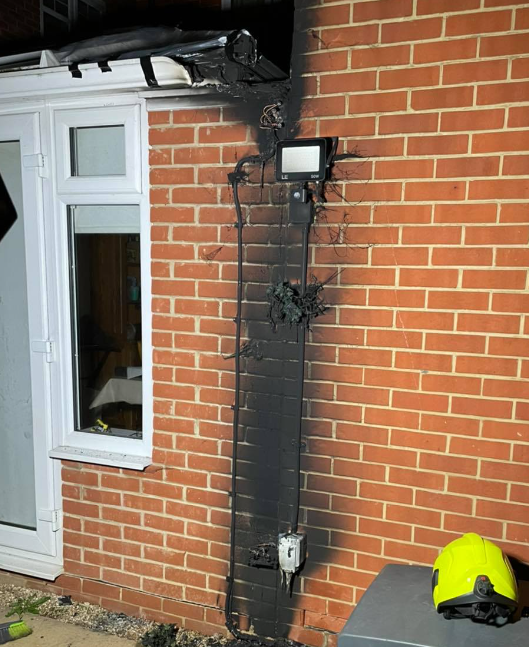

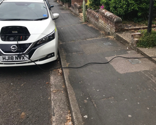

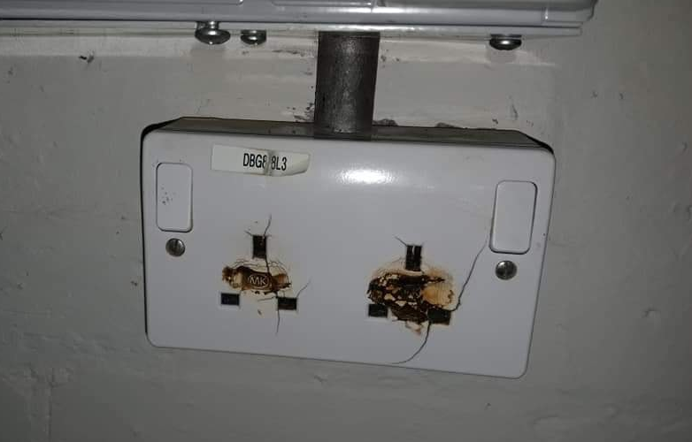

13A outlets were not designed or intended to be used with high loads for hours at a time, and they are likely to overheat if used like that.
The better charge leads have a thermal sensor in the plug to avoid that.
If people plug them into extension leads, that protection is useless. Some don't have any thermal protection at all.

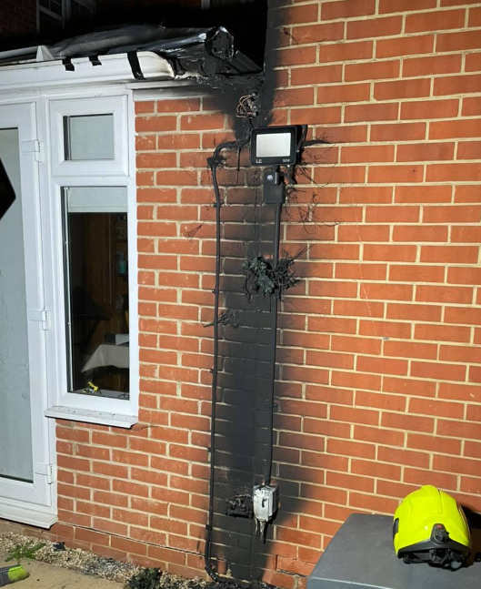

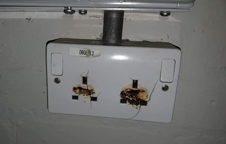

The results look like this:

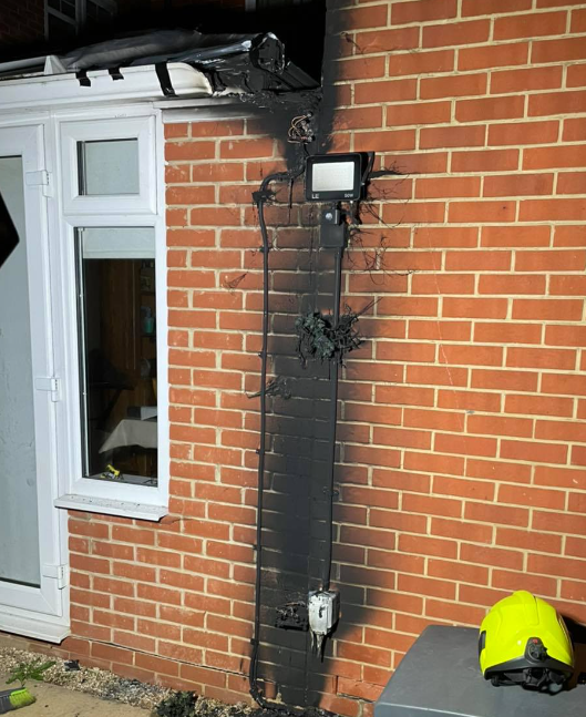

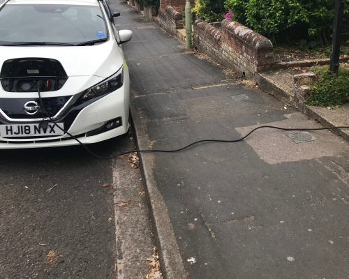

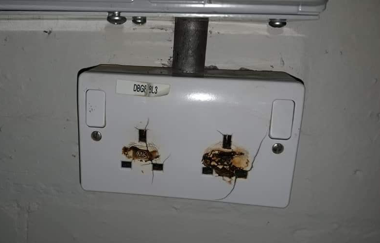

View attachment 297502View attachment 297503
