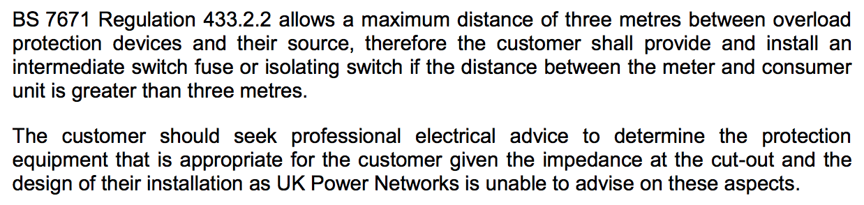

Hi all, I was aware DNOs usually have a 2 or 3m rule on tail length, which I assumed for their own reasons (simplicity/flexibility and consistency I guessed). However I was having a read of UKPNs doc and they pin the blame on BS7671 for that rule. That was unexpected.
BS 7671 Regulation 433.2.2 allows a maximum distance of three metres between overload protection devices and their source, therefore the customer shall provide and install an intermediate switch fuse or isolating switch if the distance between the meter and consumer unit is greater than three metres.
From:
http://library.ukpowernetworks.co.u...Customer+Supplies+up+to+100A+Single+Phase.pdf
The part of the reg they cite apparently applies only to circuits without adequate *fault* protection.
To determine the adequacy of fault protection purely for BS7671 you would just need the total Zs, the adiabatic parameters for the cables involved and the fuse characteristics?
So it stands to reason that they are saying their fuse doesn't provide adequate fault protection for any length of tails. They are also saying it's not the "overload protection device" for the tails for BS 7671 purposes either.
In that case what is it for? Unspecified DNO protection purposes? Or is it just there to allow meter operators to safely isolate the supply by removing it?
Thoughts?
Untrue. Or at best egregiously disingenuous.
Says it all.
Indeed.
Which is patently bo****ks.
Downstream protection for their supply cable.

Anyway, my point w as that, whatever size teh service fuse, and whatever degree of protection it provides, putting a second fuse of the same rating in series with it is not going to make a blind difference.
True! Although they don't say put the same rating, they actually say in that doc
The customer should seek professional electrical advice to determine the protection
equipment that is appropriate for the customer given the impedance at the cut-out and the
design of their installation as UK Power Networks is unable to advise on these aspects.
Which basically means you might not get 100a through one switch fuse if your electrician can't get the disconnection time low enough.
That situation would be the same if the tails were not over three metres in length, in which case the DNO fuse is not adequate.
