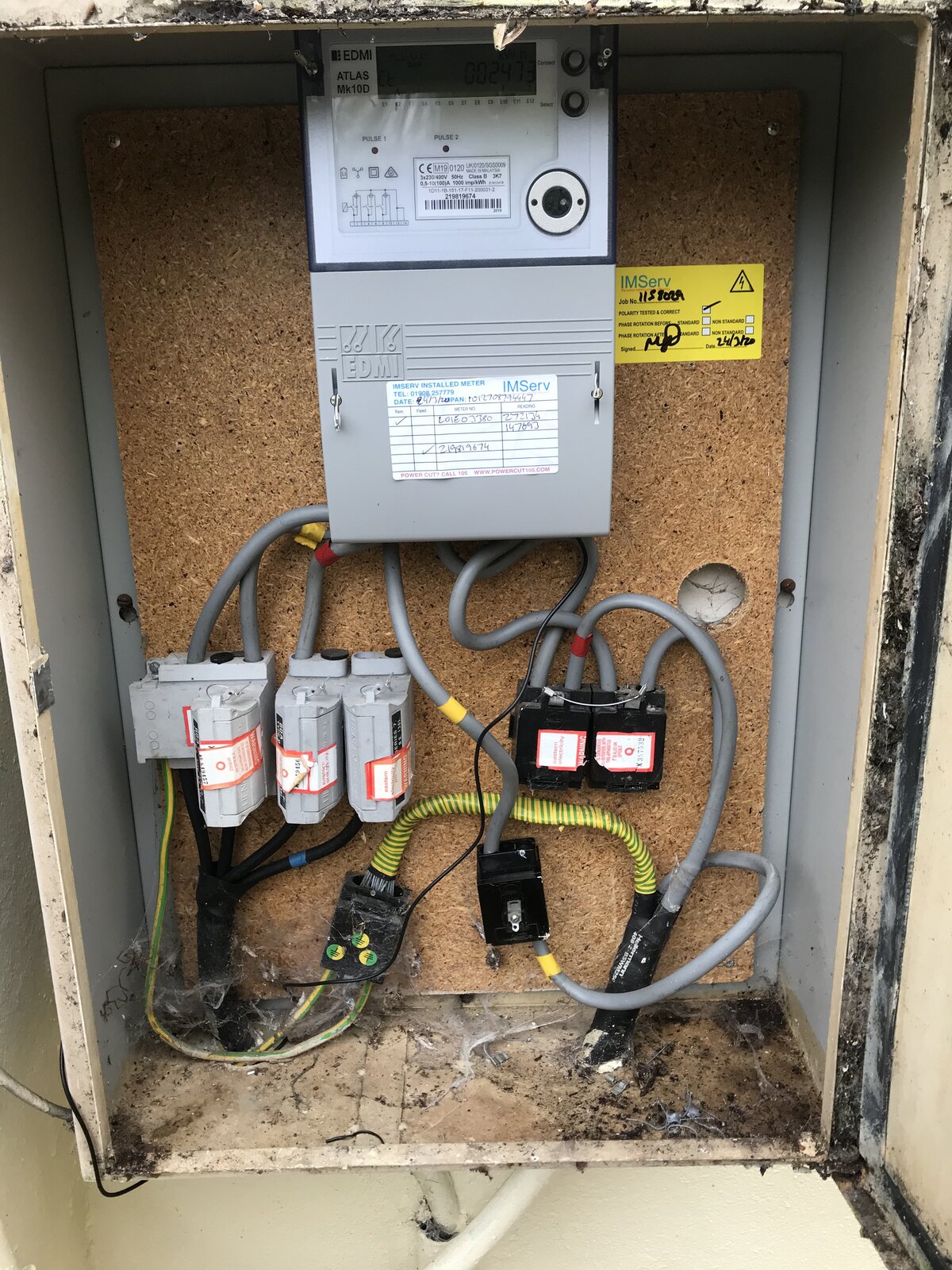

Do you literally have a TP&N head and meter in your external meter cabinet and nothing else at all for the 3 phase installed yet?
If you could post a couple of photos it would be a good help so we can see what you’re up against.

this does bring me back to taking too much of the supply coming in at the meter though. There are three 60amp fuses at the moment Could these be upgraded to 100’s & we also have a 30amp AGA.
