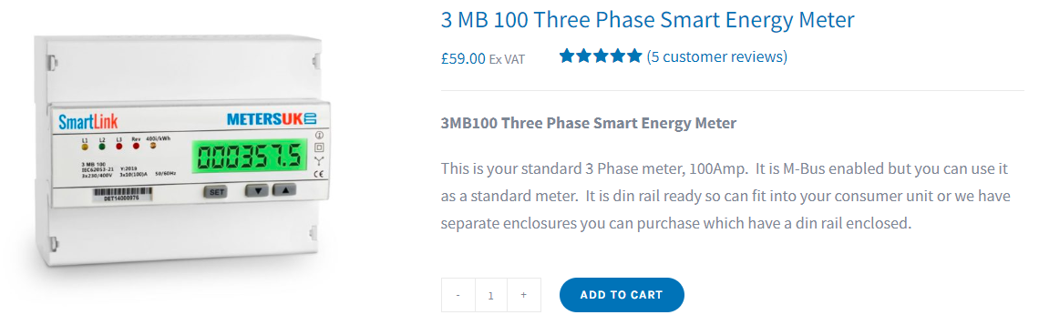

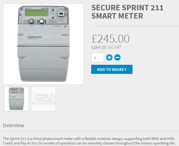

There aren't any three phase smart meters yet, so that won't work!
Really, E.on installed one some 10 years ago on my workshop supply. (it's the only smart meter that works on my plot! has an external aerial)
Are you sure about that?
So how does the power used in the hall get monitored by the admin in the adjacent church?
