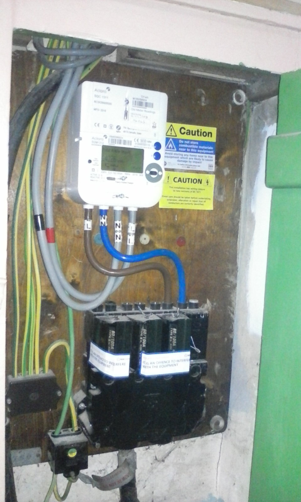

Hi Guys,
We have 3ph coming into our cottage, didn't realise that before, anyway just had the meter changed as the last one failed, big problems for our electric supplier Igloo as they didn't have any commercial guys to work on 3ph..??
well... now that I know we have 3ph obviously I need it in my garage / workshop. 15m away.
Is this a straight forward job for a sparky or do I need to have Igloo back to make the connections..?
Thanks in advance..
db.
By first glances, you do seem to have a 3 phase supply, however you appear to only have 2 phases in use.
left to right - 1= neutral/earth, 2= brown phase, 3= black phase, 4=grey phase (not in use)
You would need to check if it is true 3 phase supply, if so, you would need the grey phase checking for a fuse, then it will need connecting to the meter and a tail back out, then a suitable 3 phase isolator to then supply your 4 or 5 core swa to the garage
Not a straight forward job at all. Why do you think you want three phase in your garage?
