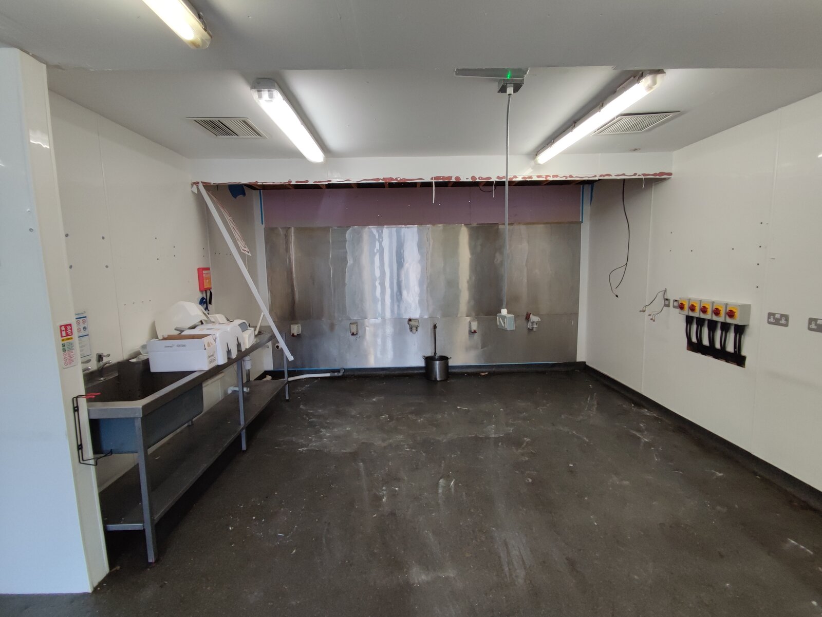

Hi all, just took over a 2nd unit at work which has 5x 32amp 3ph sockets on the back wall which will be our workshop. I think 3x are 4mm cable (3c+n+e) and two are 2.5mm.
I don't need any 3ph power but do need 20 and 32amp single phase power.
Is it OK to make up a lead with some 4mm / 6mm flex with a 3ph plug on one end and a single phase socket on the other, to allow my equipment to be plugged in?
Which of the live pins would I connect in the 3ph plug?
I'll only have one machine operational at a time. Any other questions ask away and I'll do my best to answer!
Many thanks
Michael

You should fit a suitable means of fused isolation unit between the 3-phase source and the intended single phase outlets rather than making a 'botch' conversion lead.
What would this look like?
At the moment there is a row of 5x rotary isolators on the right hand side. Would it be better to rewire the isolator so it is single phase cable coming out and run it to a single phase socket, instead of trying to convert what's already there?
That may be an option, however depends on many things such as the cable size, whether a neutral is present, protective device, what you intend to connect to it, and also whether what's there was installed properly in the first place. The photo only shows a row of isolators, so presumably the sockets are elsewhere - that in itself is an unusual arrangement.
Regardless of that, this is not DIY work. You need an electrician to assess what's there and install the appropriate equipment for your requirements.
