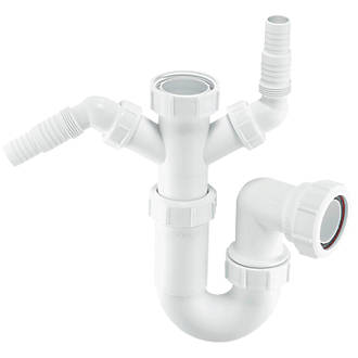

Hi. I currently have a sink trap with outlets for the washing machine and dishwasher. I also have a water softener where the brine drain and overflow currently go out through the wall and into the external downpipe. I'm getting the external wall rendered and moving the downpipe and rather than drilling through again I'd rather connect the water softener drainage to the sink trap. Do they make sink traps with 4 outlets? I've looked online but can't find anything. Any advice? I know I've got to incorporate an air gap too. Thanks.
Thought a photo might be helpful. Could I join a fitting with two other spigots to this set up? I need to tell the renderer in the morning if he can render over the existing two holes but only if it's do-able under the sink so any help is appreciated. Thanks.
Outlets or inlets, I'll just call them spigots...

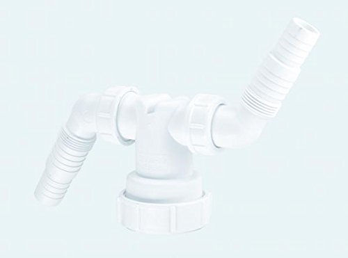

Could I add the top part of this waste trap to the horizontal grey pipe going out through the wall or does it all have to be before the U bend?
Thanks. Could you suggest how I could adapt this set up to achieve what I'd like to do? Do they do deeper U bends?
How about if I attached two of these (McAlpine V33WM) instead of the two existing spigots
But on second thoughts the pipe connector is bigger then the spigot connector, so that won't work. Scratching my head...

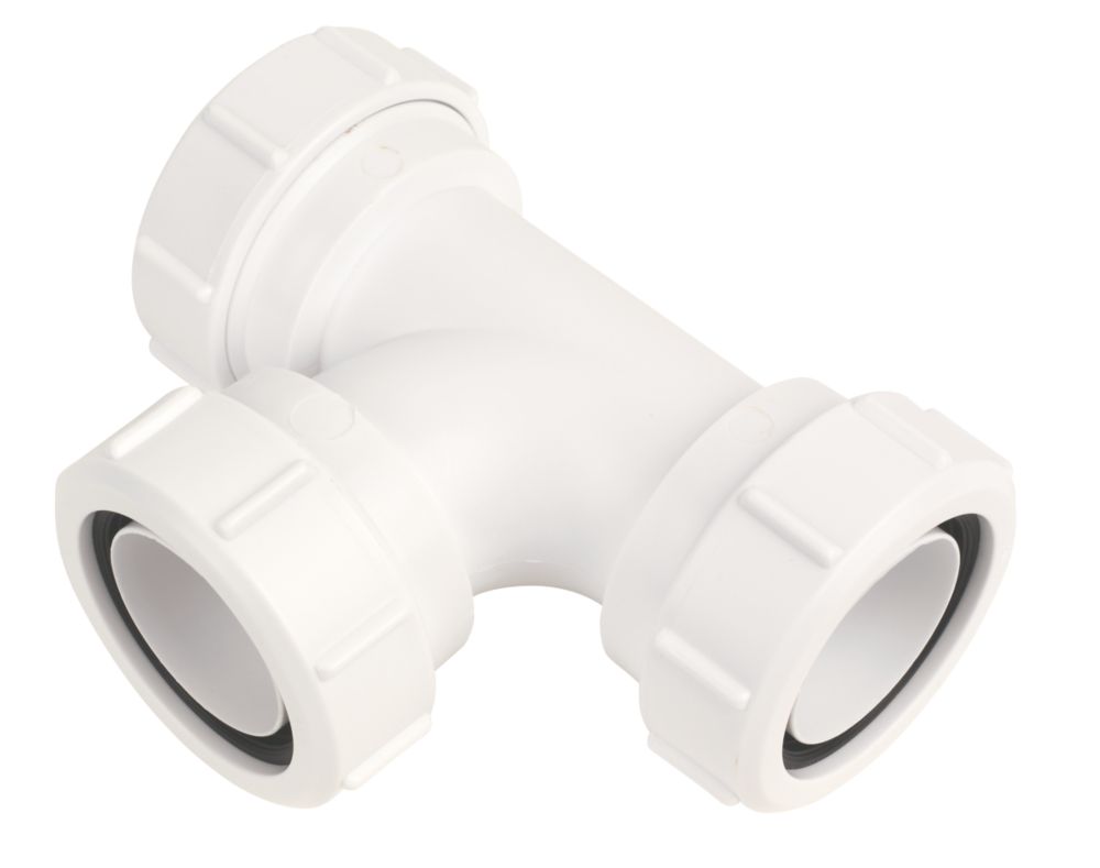

Hang on, how about after the existing two spigots and before the U Bend I add a McAlpine V1M swept tee...
ae235
...then attach the V33WM above to it for the water softener spigots...
...then extend the other side of the U bend vertical to compensate for the swept tee?
That'll make a very deep U bend and a bit of a contraption but won't it do the trick?
Okay, I pretty much know I'm talking to myself here but for anyone else with a similar issue, I don't think you can plumb the water softener drains into the waste trap because of the risk of backflow of contaminated water in to the mains system.
So you either fix them in a stand pipe like a washing machine drain. Even then I don't think you can simply push the hose in, you still need an air gap. That's where a tundish comes in. I get the theory but still not sure how they fit together..
Oh and I haven't ready anywhere whether a non-return valve can be used but McAlpine do one (T28M-NRV) so I hope I can get hold of someone there in the morning before the renderer gets to decision time... (but if someone is reading who can help that would be hugely appreciated)
