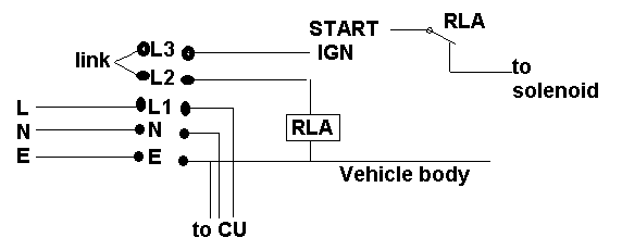

As to the concerns about incorrect application of these connectors. I say use them properly as I have come across so many silly applications, some of which are potentially dangerous:
1P power to a van using a red 3PNE, L2 & L3 had a short in the socket, in the van was a relay to inhibit the starter solenoid:
with the van was a cable with a blue plug and red socket which worked successfully for several years. On a site the temp electric supplier had been asked to provide a 16A supply and seeing a red plug applied 3ph.
Ouch !
I've seen 32/3 being used as 2x1ph (2xL & 2xN with common earth).
Both of the above did a lot of damage.
