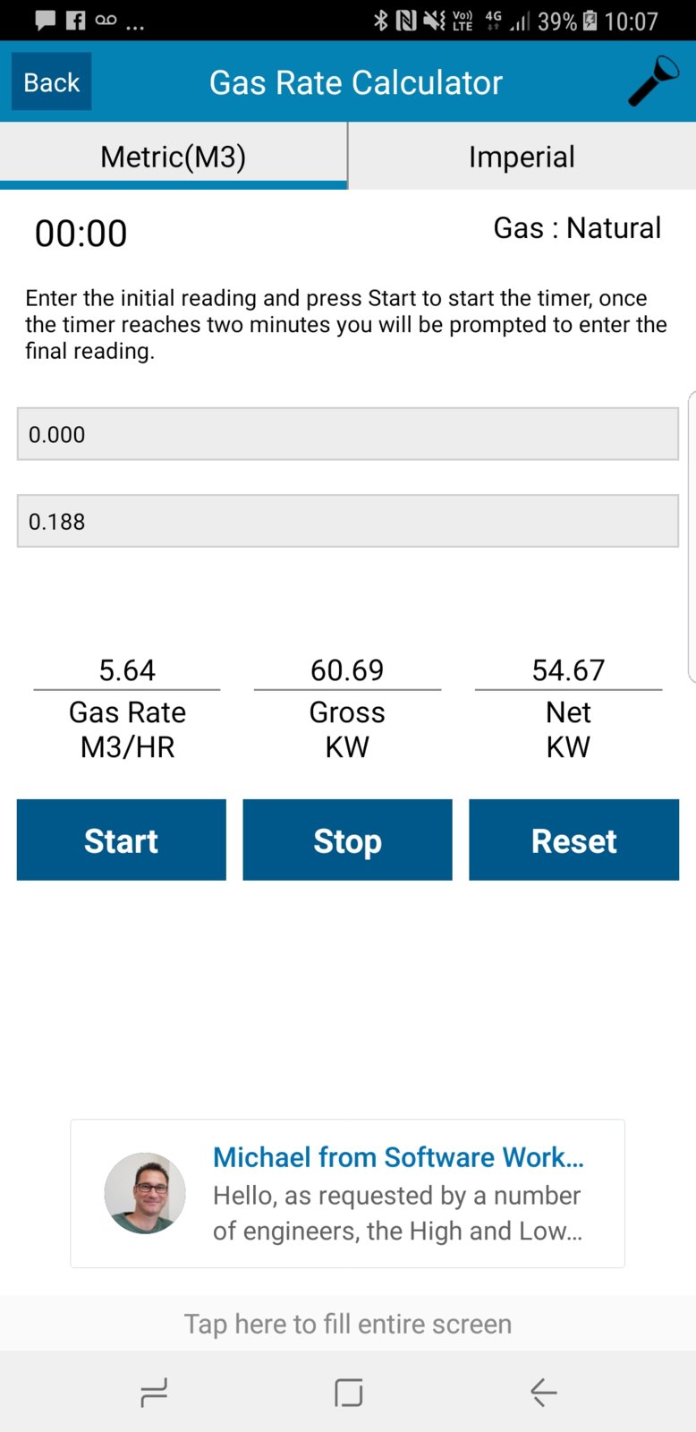

I've taken the usage from Npower and it shows about 35,000 kwh for the year
That really is massive.

Unless I'm getting something wrong here with the figures, the gas rate for the figures you provided for one min of hot water use is very high.
With using 0.188 as my difference between two readings over 2 mins i get this as a gas rate
Thanks for the quick reply.
Just realised the Mrs had put the washing machine on, which whilst doesn't take hot water - does mess with the flow rates which I'm guessing might have messed the figures up.
I'll repost values for a few tests at 2 mins as soon as it stops! :)
