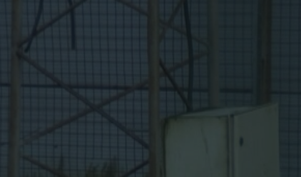

Leisure firm charged after footballer electrocuted in Portsmouth - BBC News https://share.google/DfH0pMUJ5iQSN1lEZ
Health and Safety Executive inspector Michelle Canning said the mast had become live because of damage caused by it swaying in the wind.
These are helpful in stopping it happening again. The pictureThe jury concluded that a fault to the floodlight had first been identified in November 2015, and another player had then reported suffering a shock in December 2015.

It would seem that it probably could have been avoided (hence the current prosecution), if it is true that the fault was identified a couple of months before the sad thing happened.Anyways, a sad thing happend, could it have been avoided?
