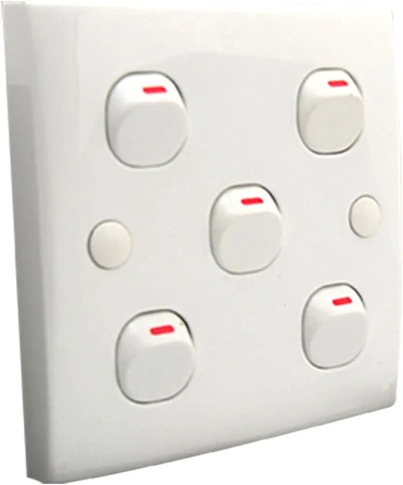

Probably not worth a post, but I've just come across this intriguing little item, when browsing for light switches on Amazon (as you do!)...
Would anyone fancy wiring this into a single back box (especially if it was loop at switch!) :)
Those appear to be Five "Standard" Australian type switches in a UK Wall-Plate.

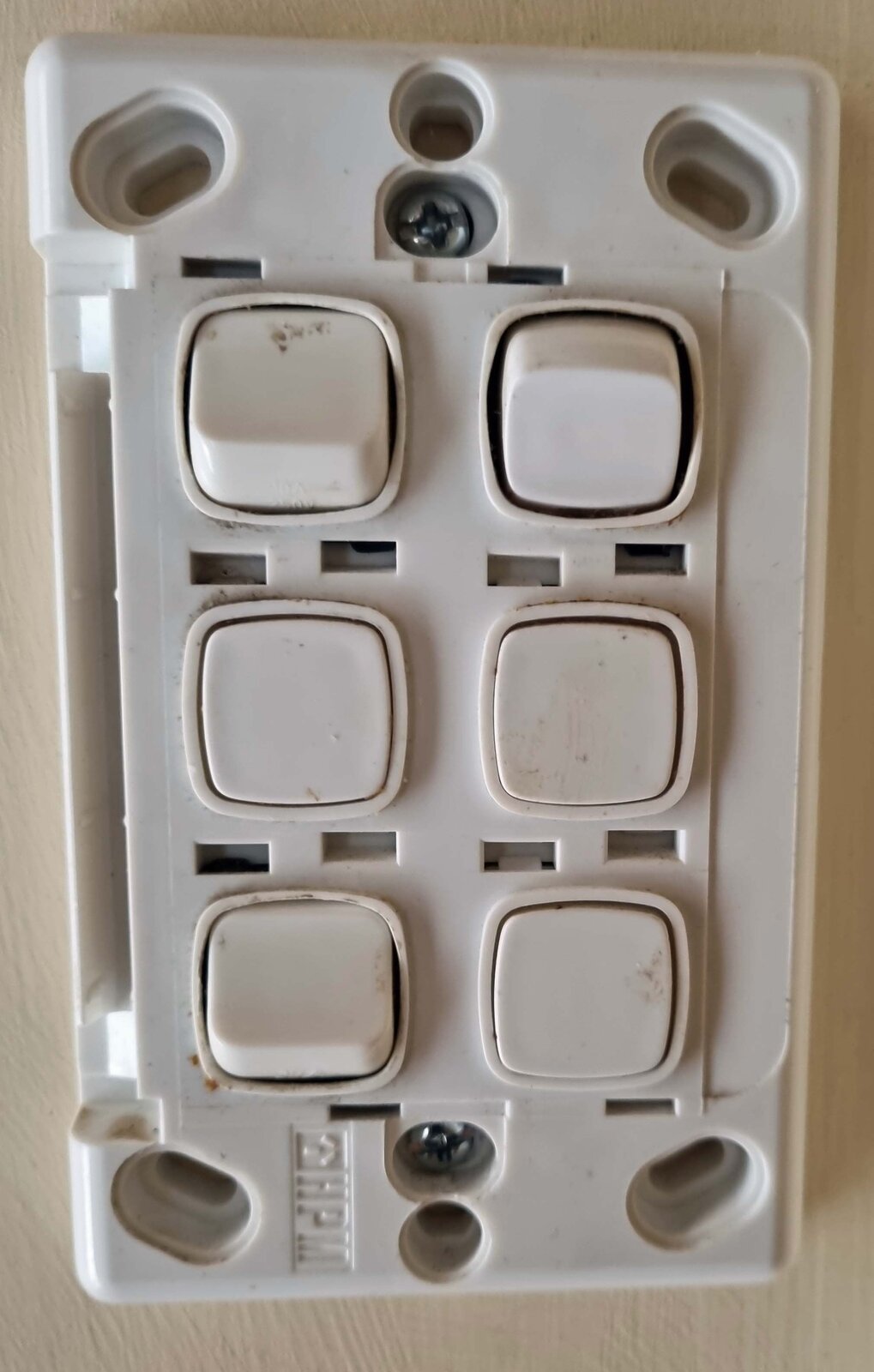

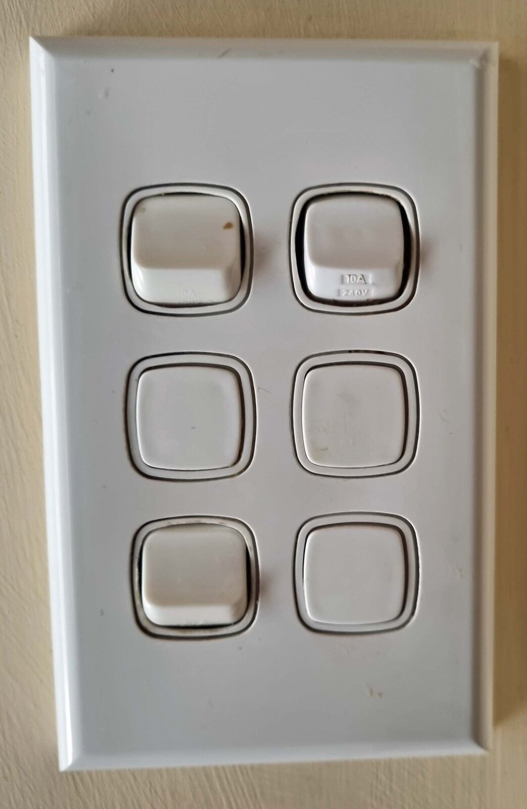

Here are three switches in a six-gang wall plate - placed this way (with Blank Mechs) to indicate (somewhat) the location of the Lights controlled.
Cover Removed.

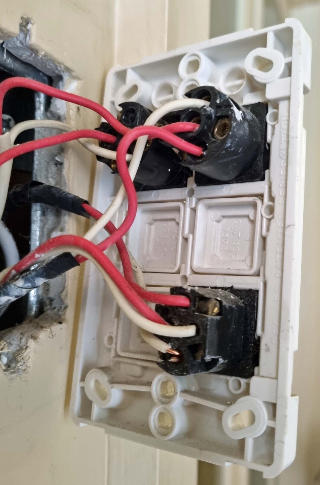

Wiring side.
Top Right switch is wired as a 2-Way.
Bottom Right switch is an Intermediate.
Asside from the issue of wiring room, the two things that concern me are.
1. There doesn't seem to be any real indication of who made it and what standards it is made to. Sourcingmap seem to be a chinese distributor and uxcell doesn't seem to bring up any relavent results in google at all.
2. By installing a weird non-standard switch you are setting up a problem for the next guy if/when the switch fails.

Sadly, there are several Chinese Rip-Offs of Australian (Clipsal-Schneider) products.
Clipsal-Schneider switches of this type were once sold in the UK but (it seems) no longer.
Clipsal-Schneider do not sell any of their products in Australian "Big Box" stores.
Their place is taken by DETA (copy) products.
HPM - now owned by Legrand - do sell similar "quality" products in such Australian stores.
Clipsal stuff like the switch in the first picture was sold by B&Q in the 80s and possibly into the 90s.
There was a wife variety of colour options.
As a kid in the UK, I remember seeing switches of this style (both as standalone switches and as part of switch-sockets) a lot in static caravans on holiday parks. I rarely if-ever sawy them in permanent buildings. Don't think I ever saw 5 on a plate though.
Nowadays Schneider do make electrical accessories for the UK market, but the switches are more normal UK style ones.

I have handled some of these, the modules are deeper than regular switches so definitely need deep boxes and the modules are too wide to fit in plasterboard boxes
Six switches in one wall plate could be wired with one "pair" and five single conductors.
That seems to imply that, for at least some (most?) of the switched loads (I presume lights), the 'live' and neutral conductors do not necessarily 'travel together'. If that's the case, it's not too good an idea in terms of 'EMC'.
Kind Regards, John
I`d probably us a 6 gang switch and not use one gang - labelling etc not to use
