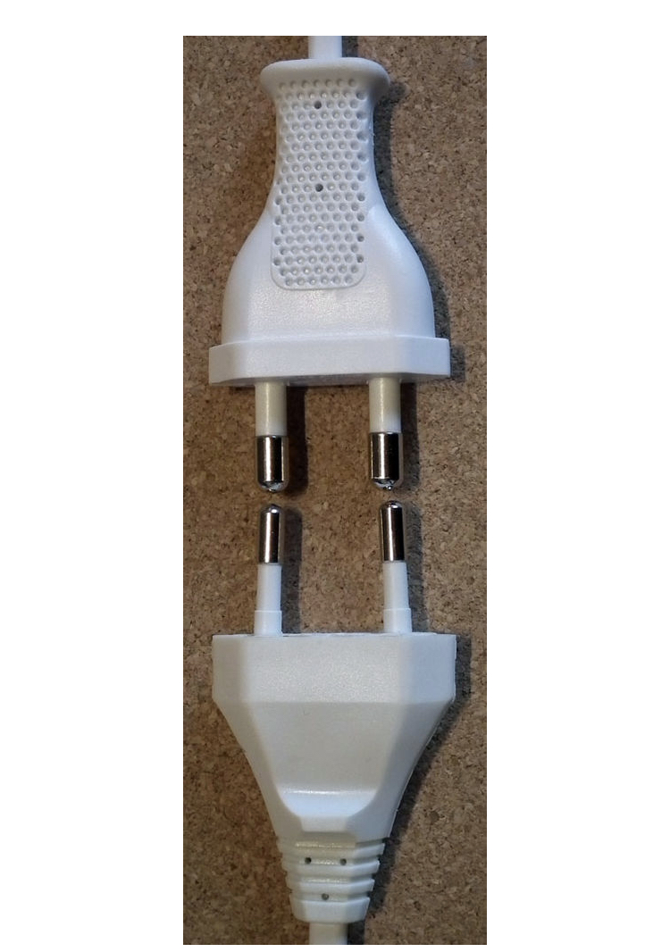

Could someone confirm the spacing and size of pins is the same between these please.
The pin diameter is almost identical but spacing is different. The UK shaver plug is slightly narrower. The UK shaver standard is based on the old 5A round pin plug.
So a shaver plug won’t fit a standard 5A socket, and vice Versa.

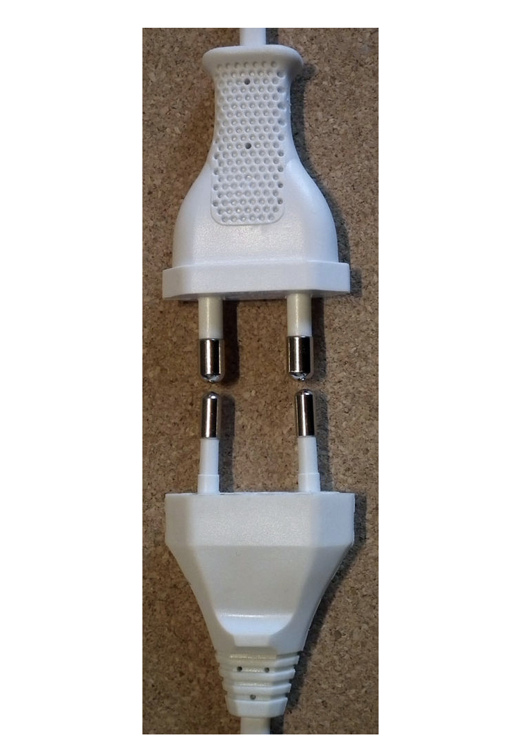

@AndyPRK has not stated which 5A socket, but I suspect it is the usual Euro- two pin socket?
If so, here’s the difference
Comparison of (top) the BS 4573 shaver plug with its parallel 5.1 mm pins that are 16.66 mm apart with the Europlug with its 4 mm pins converging slightly from a distance of 18.6 mm apart
Not the same, different.

My understanding is that the shaver plug has the same dimensions as the historic 5a 2-pin plug, which for some reason has different pin spacings from the 5A 3 pin plug, even though both were, at one time, covered by the same standard.
Found a shaver plug. 16.6mm pin spacing. (spec on it says BS4573)
Spec of 3 pin 5A (0.75") 19mm pin spacing.
Damm!

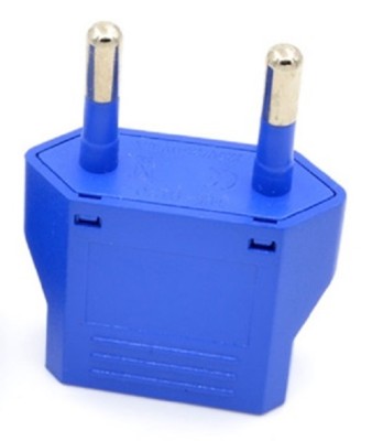

Usless info: So what I have learnt is that I could stuff a Euro plug into an old 3 pin 5A socket, and while loose may work. This however is not the combo I wanted or find useful.
Didn't know you could get these 2 pin adaptors:
