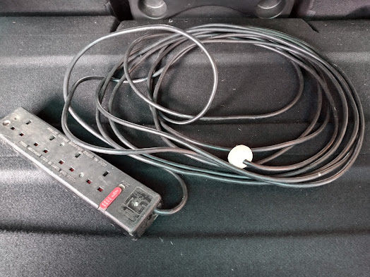

As to a caravan with the 25 meters of 2.5 mm² cable I have not seen a real problem with 16 amp, the problem seems to be when lighter cable is used. I found the cable tidy
shopping
would not take 25 meters of 2.5 mm² normally I would lay as figure of 8, however is this cable part of the installation or an appliance? I have seen once or twice where sites have asked for an electrical certificate, but I would say it is only valid until unplugged and moved, so one would need a loop impedance meter and RCD tester with the caravan. I do see how a simple plug in tester is a good idea to ensure there is an earth and line and neutral correct way around
shopping
and yes the plug in tester would show this, however to complete paperwork every time you moved site is not really practical. It would need some one who could show they had the skill required.

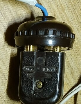

As said before it is a number of tens of decades since I'd seen one of these 'screw top' 5A plugs:
Monday I attended a fault reported as 'Everytime I touch the computer I get electrocuted'.
I found an extension lead plugged into the adjacent room:
At least someone had thoughtfully marked the positive and negative pins(y):
And the wiring side of it:
At least the 'cable grip' had been used but not big enough for 2 lots of insulation:whistle:.
The annoying thing it the 5A switched socket is on the elderly 3/0.029" lighting circuit but the surface mounted ring circuit is brown/blue T&E in trunking. Adding a couple of DSSO's into the ring was exceptionally easy from the trunking the other side of the wall as the hole was already there, presumably from a previous pipe.
As said before it is a number of tens of decades since I'd seen one of these 'screw top' 5A plugs:...
I think I still have some 'hoarded' ones somewhere (and certainly plenty of light switches with 'screw off' {'without a tool'} covers)!
Kind Regards, John
