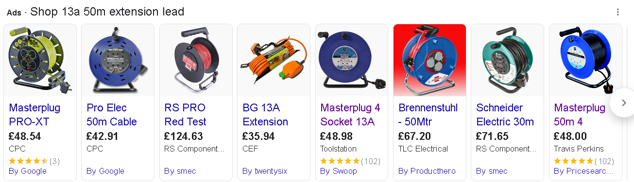

Extension leads should not exceed the following lengths:
Core cross section area Maximum length
1.25 mm2 12 metres
1.50 mm2 15 metres
In the unlikely event that an extension lead does exceed the above lengths, it must be protected by a 30 mA RCD (residual current device)
Read more: https://www.diynot.com/diy/threads/failed-pat.580522/page-2#ixzz7B9Vt9R4b
That list causes so many arguements when a brand newpurchase from one of these
is failed on pat before ever being put into service.
It also leads to crazy daisy chains along with all of the stress and strain placed on additional plugs and sockets.

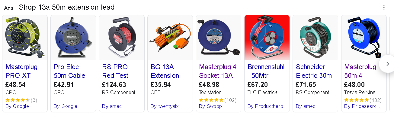

Our P.A.Testers had a lead length calculator built in to get a suitable resistance for a long cable.
This was one of the benefits of us doing the testing, rather than contractors. We can use a common sense approach (as long as it's backed by the RA), rather than a contractors 'one size fits all' interpretation of the guidance.
We still, needed the odd trick to get items to pass - Scotchbrite is a Testers friend! ;)
