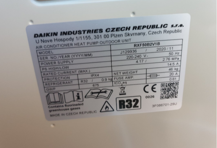

Hi John thanks for your response I have uploaded a picture of the unit specs if that helps in respect to the 14.5 amp
Thanks. It doesn't really help. However, if its around 5 kW then I would assume something like 20A maximum (and forget the 14.5 A, whatever that may be), which is consistent with their calling for a 20A fuse.

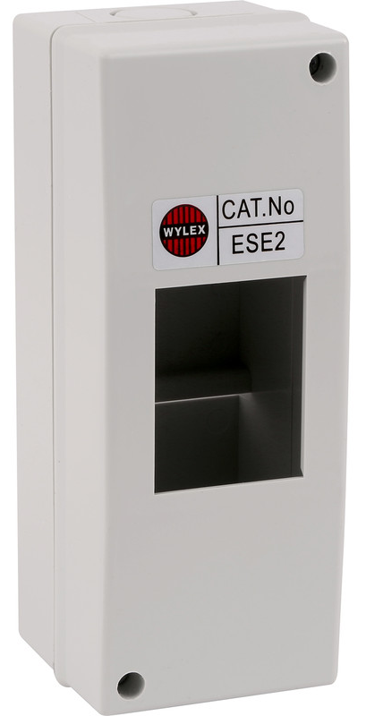

From the centre of the ring you could take that load, however there is no 20 amp FCU so it would be likely a mini consumer unit upload_2021-6-19_7-22-57.png as to if it needs a fuse or MCB not sure, some inverters need a semi-conductor fuse to protect them MCB's are too slow. But likely would be a MCB. As one leaves the centre of the ring the problem is overload of the ring circuit. So one would need to measure the loop impedance to see if near centre or ends of the ring.
Using a cooker connection unit and a MCB in the main consumer unit would be neater. It also depends on if 20A is maximum size, or if a 32A could be used. People tend to read any overload protection must be included in the appliance, the fuse in plug only protects cable, but fail to realise that is only true with a portable appliance, with a fixed appliance the manufacturer can stipulate protection required, so it would need careful reading of the instructions.

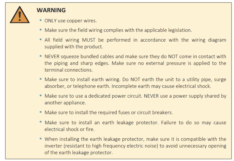

Very true what @zebedee2001 says I am not sure I would want one of these
on the wall.
