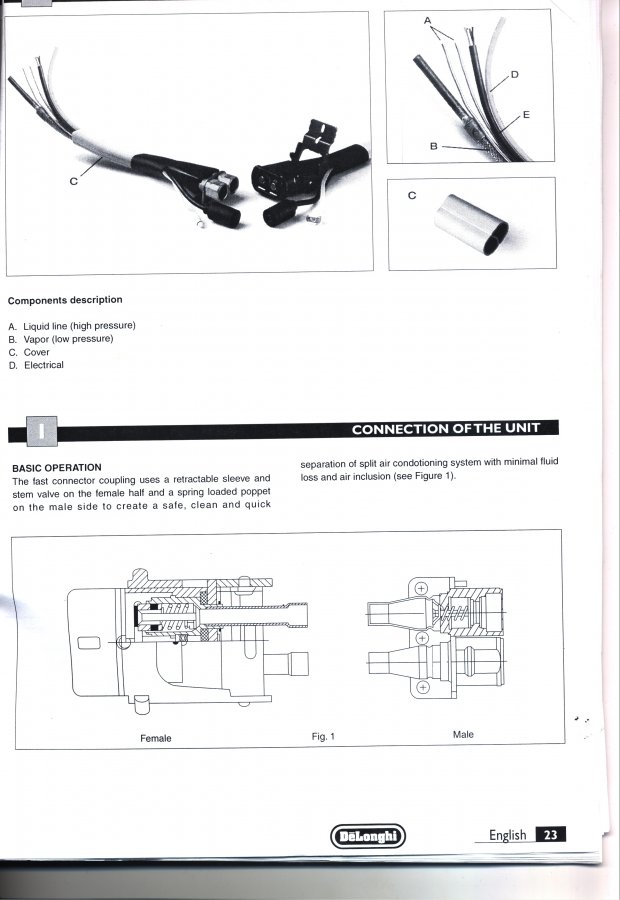

Looks like you can still get the self-install units - plenty of air-con suppliers on line seem to have them. So long as you are OK with the 4m pre-installed piping, there is no requirement for vacuum pumps, gassing, etc. The external unit is pre-purged and the valves in the unit's connector are opened when you lock the quick-connector in place (it's the exact same system that is on mine).
One thing I did find is that you need a fairly large hole to get that connector through the wall (though not as large as someone mentioned in a early reply), so more making good afterwards, and the bend radius of the sheathed pipe&cable bundle is quite large - a pro installation should be neater! I took my piping down through the floor and out through the plinth directly in line with the condenser connector, so mine is fairly neat.

Ah I see what you mean davelx. I've just had a look at one on a you tube clip....the one with the handle similar to that on a ratchet strap that pulls the connections together? Very innovative design.
In that case I stand corrected. Presumably the action of that connector must be to seal the joint at the same time as depressing some sort of valve...or is it to pierce the ends of the pipes?
I wonder if it seals again when disconnected?
I haven't seen any, or the video you mention, but there are a few designs of connector like that - each side has a sealing valve which is opened when the two halves of the connectors are put together.
I'd expect them to seal - it's fairly easy to do. I've used several designs on agricultural hydraulics - they all lose a small amount of fluid every time they are unmated ... There are some specifically sold as low or zero loss, though I'm not sure I can see how to make a design that's got zero free space between the halves all the time until both sides are sealed.
Exactly
No
Yes, according to the installation manual. I've never had to disconnect it though.
