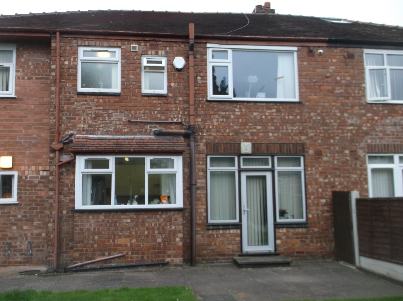

Was it perhaps a bay window like this, with a short wall below the window?

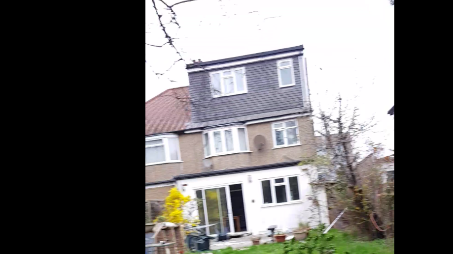

I don't have a bay window on the ground floor just a 3 meter extension. I have a bay window only on 1st floor see image. I will take a clear image tomorrow morning.
Sorry - i misunderstood.
But before the 3m extension was built, the bay would presumably have been on the ground floor as well?
If so, it is being regarded by the council as an original wall forming a side elevation; the fact that it's no longer there is irrelevant for Planning purposes.
no idea if there was a bay on the ground floor as when i bought the house it was already having the 3 meters. the fact that it's no longer there is irrelevant for Planning purposes does that mean i can no longer get 6 meter extension.
Good God that's horrific, I had to come out of retirement for this one, someone appears to have taken a massive crap on the back of your house, perhaps you should consider demolishing the lot and starting again, gotta feel sorry for your neighbour too, you've cost him about £20K if he ever wants to sell.
Hard to see definitively but it looks like your poor neighbour still has the original bay at ground level.
Once planning gives me a lawful certificate than only i can spend money to bring it up to the high standards i want. Neighbour house don't have the original bay also they have 3 meter extension also.
