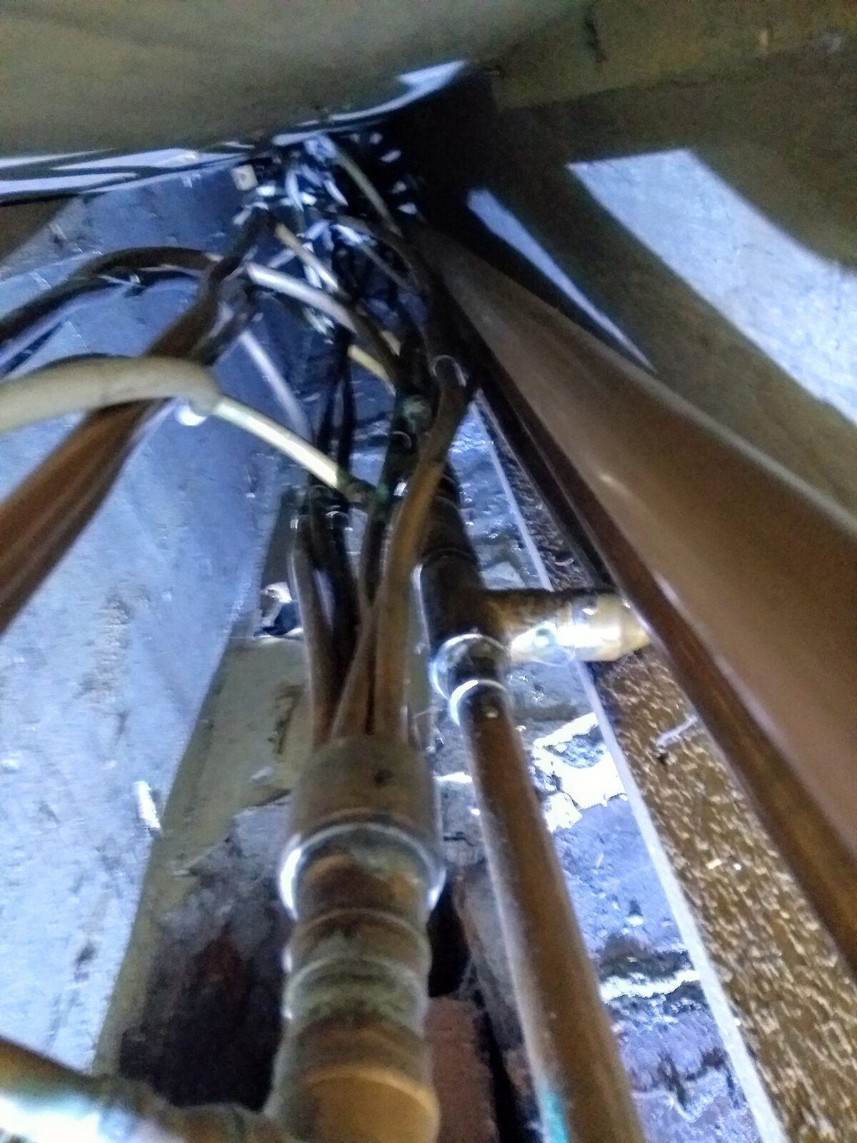

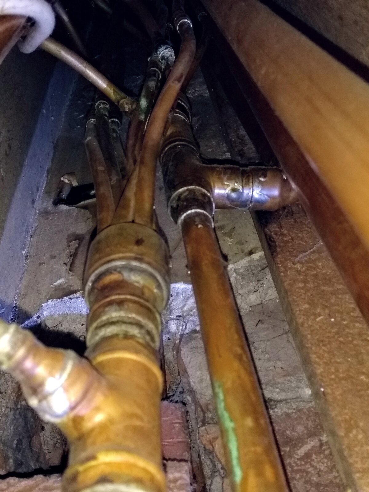

Hi Folks
I've been on the heating system today. I think I've finally found my microbore manifolds. They're logically located (yes I am being sarcastic) near the bottom of some pipe boxing running up the side of the chimney breast. They seem to be linear type manifolds pointing upward. The pipes for the first floor radiators go all the way back up the chimney breast (the boiler is in a bedroom), whereas the ones for the ground floor go up for a few feet before doing a U-turn and coming back down again! Genius. I suppose they could have located them neatly in the floor voids, but that would be too simple.
Anyway, I can't actually see them. By feel, they appear to be 6 way (It's 8mm). Thing is, I can't find a 6 way linear manifold available, so I'm wondering if they even exist and my pipe braille skills are just not that good. Has anyone come across one of these?
Assuming this is the case, I'm thinking of trying to tidy it all up be replacing with one or more side-feed type manifolds. Probably intercept the flow and return at first floor level to avoid an unnecessary round trip to the ground floor at least and have another for the ground floor. That should tidy up the Gordian Knot of microbore piping.
However if anyone knows why there might have been a good reason why it was installed the way it was, and I should therefore leave well alone, I'd love to know!

Yes - but this is definitely a 'sixer'. I've attached a couple of pics to show, as I managed to get a mobile in at arms length. The pictures are looking 'upwards' Beneath the manifold you can see a tee for a 7th connection.

Yep that's very like the one(s) I have. Could be the actual one(s). Discontinued in 2022 I see. Not that I'd want another one of those, but if anyone knows of availability of one of the side-port type (with compression fittings as far as I know) would be very interested to hear. Can't see any online, even 'discontinued'. Perhaps some 'traditional' suppliers could have some gathering dust on a shelf.
