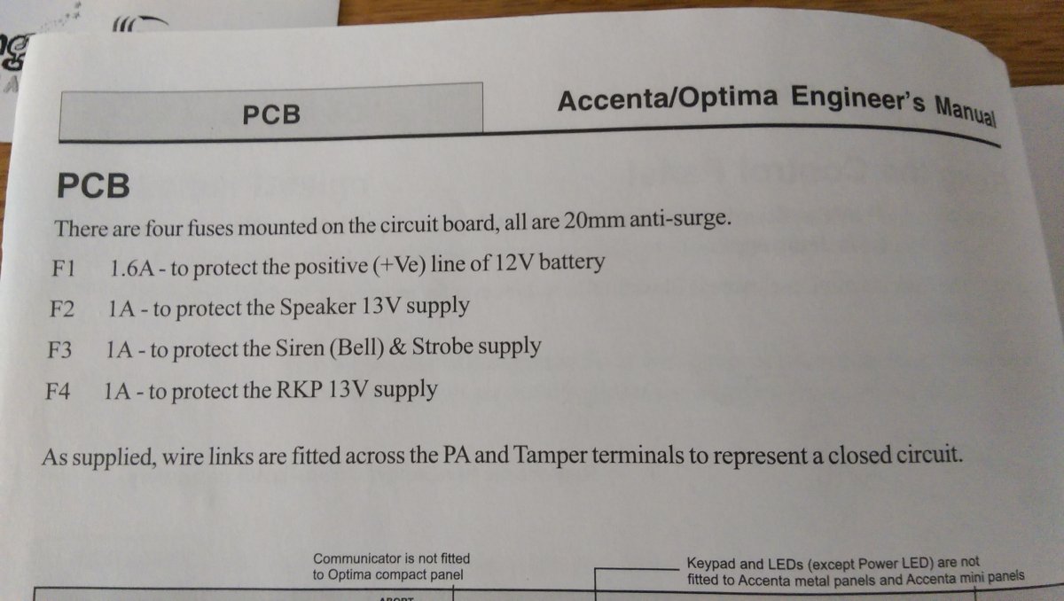

Yes there is a small fuse for the pir supply. Should be a simple fix depending on why the fuse blew.
Thanks musszzy! I take it its one of these fuses then?
Hi musszzy
It is a blown fuse, but it's F2. Just got to order some 20mm 1amp anti surge fuses.
eBay beckons..........
Thanks again musszzy!
No problem... Wasn't very clear which one supplied pir power. Hit the thanks button if you check back in. Ta

PCB
There are four fuses mounted on the circuit board, all are 20mm anti-surge.
  1. F1 1.6A-toprotectthepositive(+Ve)lineof12Vbattery
  2. F2 1A - to protect the Speaker 13V supply
  3. F3 1A - to protect the Siren (Bell) & Strobe supply
  4. F4 1A - to protect the RKP 13V supply
    Have you checked the internal speaker ?
    You could do as muzzy says and link out all devices,but leave the speaker connected and then set the alarm and trigger the system by causing a tamper on the control panel lid to set off the alarm to see if speaker is faulty and blows fuse.
    If you have multimeter ,meter speaker for ohms.
    Speaker could be 32ohms or 16 ohms.
    You will have to start isolating items to determine fault
