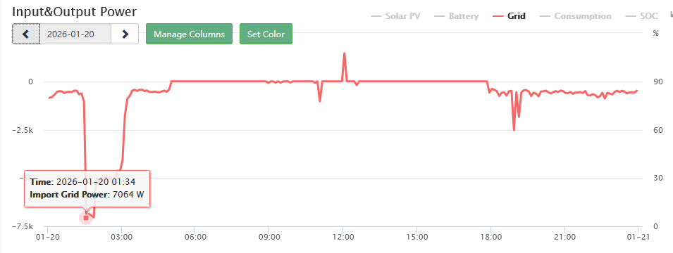

I am sure, like me, you know what you are using when. 1768953692670.png So I know I use 7 kW overnight on a regular basis. So I know I would be using 60 amps on a regular basis, so would be a bit risky for me.
