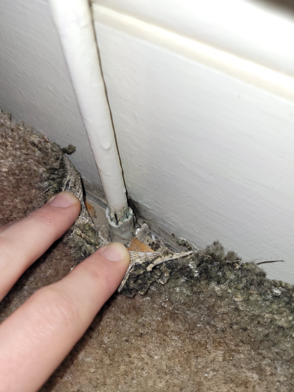

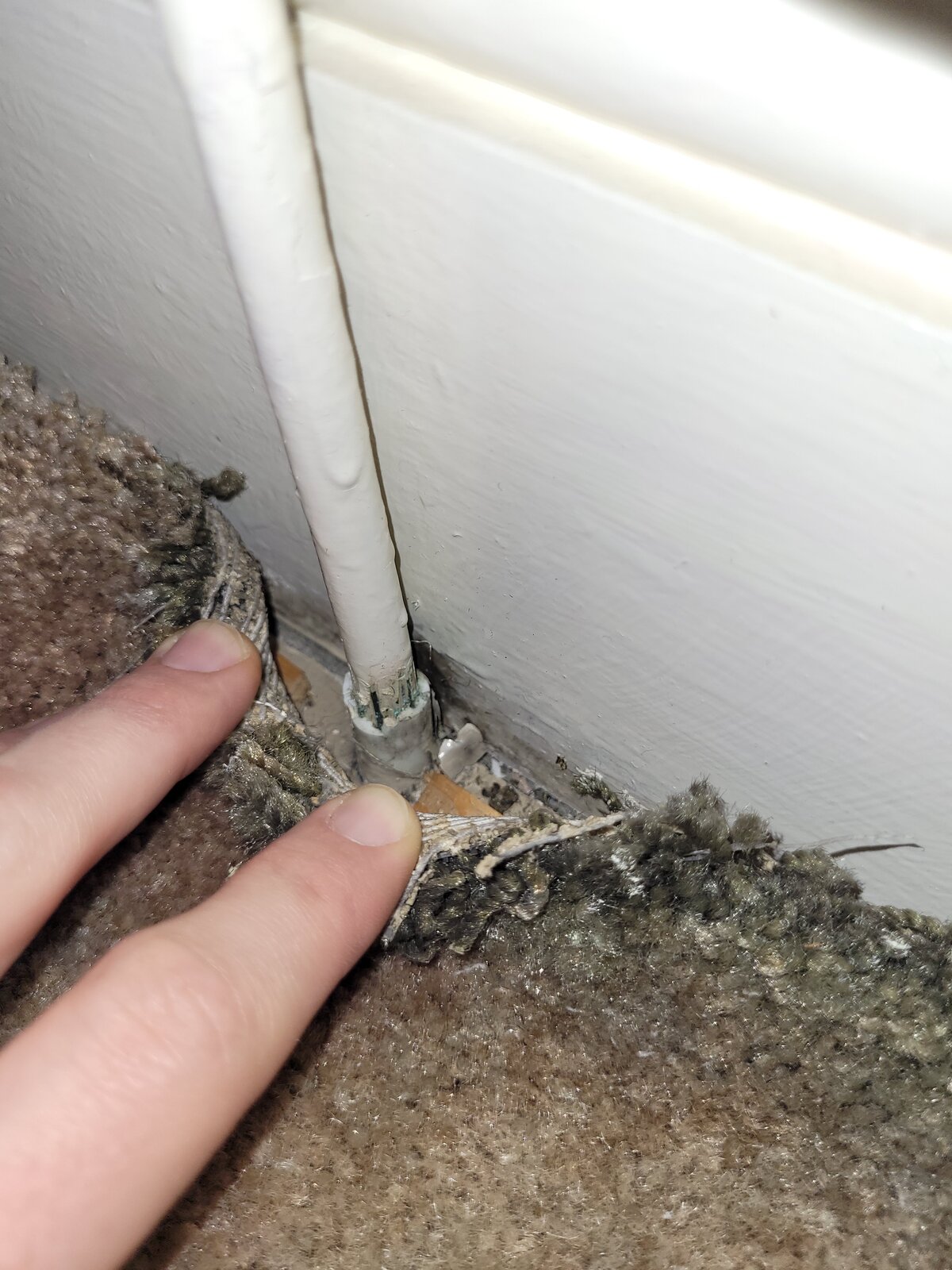

Q4 I just pulled up some carpet and took this photo of the pipe in screed, does this look like the type of wrapping you are talking about? Would this make digging out some screed to connect the extention rads to existing downstairs a better option than routing down from 1st floor? I will be getting a heating engineer to do all the work but want to try and avoid regrets from doing work based on a single opinion.

Your pipes- it looks from the pic as if it's been coated with something but I can't tell what. No visible corrosion where it drops into the screed (which is a good sign).
