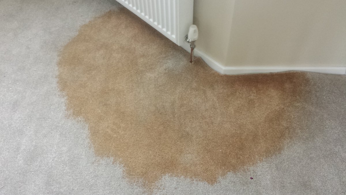

When you were taking radiators on and off what was the water comming out them like? drinking water? bit dirty? Black oil?
Thanks guys for your response. I will set the gas valve to fully open position and will get a fixed price quote from Vaillant.
@ScottishGasMan The water that came out from the radiator was brownish and has left a stain on my carpet (getting rid of the stain by using Rug Doctor spray). See attached pic.
FYI dirty water in the system can block up multiple components which can easily cause the noise above. But there not easy to clean hence the possible high repair bill to get it sorted with replacement parts. Get vaillant or Bg on fixed price repair
